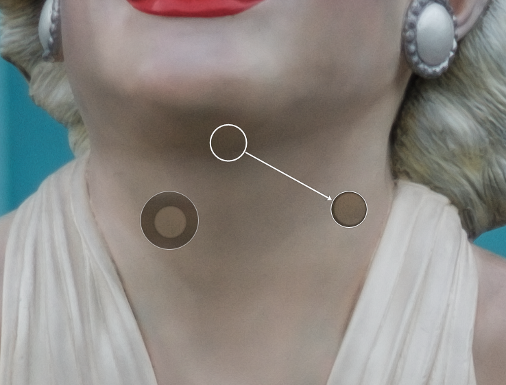

I just did a test and added 2 adjustment brush marks with Exposure set at +2 then closed and opened the Spot Removal tool set to Clone. Although I could not get rid of the +2 brush circles completely I could make them change.
The OP is suggesting that the Clone and or Heal Spot Removal tool does nothing on those spots.
That is why I said it was a monitor problem.
There is nothing in any of the LR tools that would cause some other tool from working.
