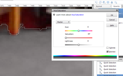

Changing from red to grey is fairly easy.  Here is one way to do it.
  • Use the Quick Selection tool to select the carpet.  You may find that part of the couch is easily selected also because of its hue and the lack of contrast.  But use the Alt key to subtract those portions of the couch that get included.  To get a better selection, particularly around the small table, you need to zoom in closely to that area of the image and adjust the size of the selection brush (by using the square bracket keys).  Using the left square bracket key, you can reduce the size of the brush to just a few pixels which allows you to get between the legs:
  • Once you have selected the carpet, go to Enhance>Adjust Color>Adjust Hue/Saturation  (or press Ctrl+U).
  • In the dialog, reduce the Saturation slider to 0 and adjust the Lightness slider to get the desired shade of grey.
You should be able to achieve something like the following examples:
I just noticed that the area under the TV is not selected in my sample.  You may need to reduce the size of the Selection Brush to 1 px to get a better selection in this area which has very little edge contrast between the carpet and the objects.  Here is a slightly better selection, but you need some patience, depending on your editing needs.
Votes
