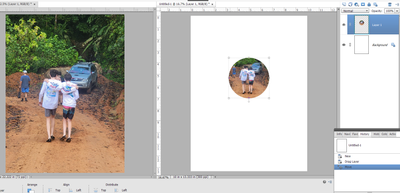

Hi - How do you change the size of the marquee selection?  Sometimes when I try it distorts what is in the picture, other times it just enlarges or shrinks the selection without distortion.  I can't figure out what I'm doing different between the two different scenarios.  I did figure out that to move the marquee tool you point to the center of it then you can click and drag.  Any help would be appreciated!  Thanks in advanced!

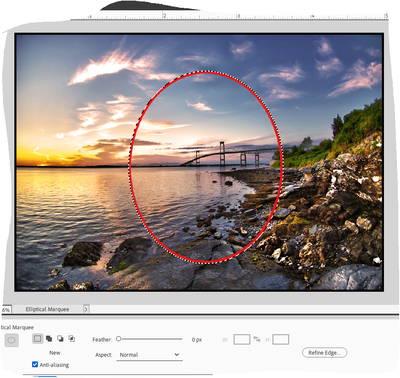

I agree that the elliptical marquee selection tool can be difficult to control.  But, here are some more tips to help you:
  • When dragging out the oval selection (without using the Alt key to start from the center), imagine a rectangle surrounding the intended oval/circle, and click-and-drag diagonally from one corner to the other.

  • Once you have created the selection, you can change the size of it by choosing Transform Selection from the Select menu.  This will bring up the actual rectangle

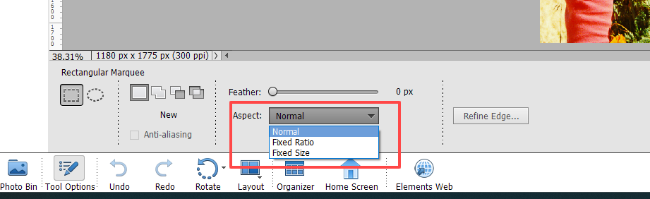

Make sure that the Aspect dropdown menu (in the Tool Options panel) is set to Normal:
If that doesn't solve your problem, please provide a screenshot of what you are talking about.

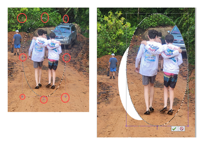

Hi - Thank you for your help.  The Aspect is set to normal.  I'm trying to resize a marquee and I click on the Move Tool to attempt to resize but most of the time this results in distortion.  I "hit it right" sometimes but don't know what "right" is.  I attached screenshots as examples.  One before trying to resize and one during resizing.  I'm sorry that they are just links.  I don't know how to get them to show up on here instead of being clickable.  Thanks!
Jun 12, 2023 Jun 12, 2023
Sorry, but I still don't fully understand what you are trying to do.  Are you trying to change the size of the selection (created with the marquee selection tool), or are you trying to change the size of the contents of the selection?
Your Original screenshot shows a file with a white background and an added circular layer of flowers (presumably copied from another document).  I do not see any selection made in that file.
The Resize screenshot shows a document with a single layer.  There appears to be a circular selection made at the center of the flowers and the selection has been moved slightly with the Move/Transform tool active.
So, are you trying to select all of the flowers in the center and enlarging the selection so that the flowers appear larger on the document?  If so, you need to do a better job of making the selection.
You say:  I did figure out that to move the marquee tool you point to the center of it then you can click and drag.
I now take this to mean that, once you have made a selection with the marquee tool, you know that you can move the selected pixels by clicking the selection and dragging it to another area of the page.  This is what shows in your Resize image.

I believe this is happening, because you are using the Move tool to move the handles of the selection around.  If you are in the Transform mode, the selection can be distorted in various ways.
I hope I have read between the lines sufficiently to help you.  Otherwise, please explain in more detail.

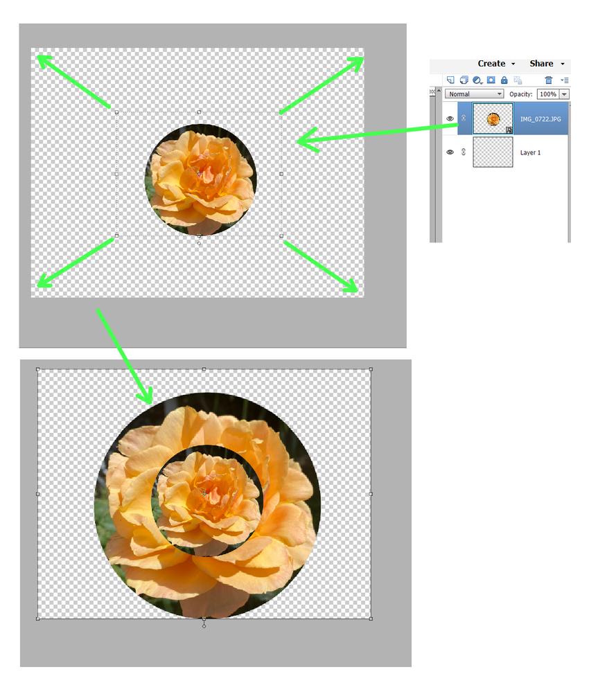

I should also have mentioned that in your Original screenshot, it would be possible to select the circular flower layer in the Layers panel.  This will bring up some layer handles that can be dragged, using the Move tool, so that the whole (selected) layer is resized as shown in my screenshot below.  (Note that I have combined an additional resized layer with the original, just to give you a better idea of what happens.)

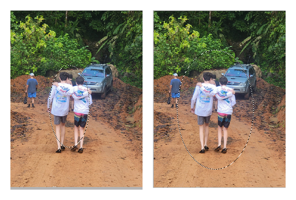

@niagara94 said:  In the picture I was working with originally it was a photo of 2 people and I wanted to draw an eliptical shape around the people but it wasn't the right size but when I went to resize it the photo of the people was distorted.
I'm sorry, but I still don't fully understand you.  What wasn't the right size?  Are you talking about the size of the selection elipsis around the two people?  Or the size of the selected people when the selection is moved to another document or increased in size on the same image?  And what tool are you using when you went to resize it and the people were distorted?

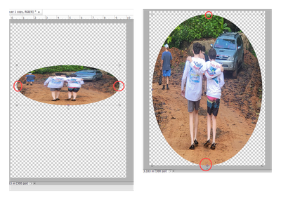

You will see that I have now selected the layer with the circular image of the boys and that there are 8 small boxes or handles around the layer (4 on each corner and 4 in the middle of each side).  If I click and drag any of the corner handles, the size of the selected layer will be changed proportionally and no distortion of the image will occur, as shown in the next screenshot:
However, if I click and drag on any of the side handles, the image will be resized but will be distorted:
The same consequences will apply, if you are trying to resize the selection in the original photo, for example by changing to the Move tool after making a selection.  Only the pixels within the selection will be resized and/or moved.
  • Once you have created the selection, you can change the size of it by choosing Transform Selection from the Select menu.  This will bring up the actual rectangle with handles described in my earlier post.
  • After starting to drag out the oval, press the Spacebar (while still holding the mouse button down), and you can move the selection around.  Release the Spacebar and you can continue to draw the oval to the desired size.  Only release the mouse button when you are satisfied with the shape, size and position of the selection.
  • Once you have released the mouse button to create the selection, you can click inside the selection and move it around.
