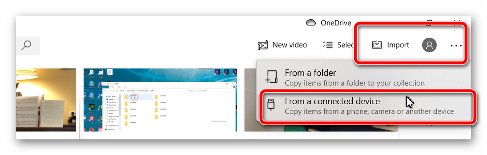

So just to add to what Michel has said, I don't think your problem is related to Elements and I don't think an upgrade will make any difference in what you are seeing.  My only other suggestion is that you try to import the files from your camera card, using the Windows>Photos app.  This should at least confirm whether or not the problem may be with Elements or your hardware.
If you are able to import the files to your computer via the Photos app, you can then import them into the Organizer, using the Import>From Files and Folders option.

I don't understand where to find the photos app. The print is so small in your screenshot that I can't see it. Could you please tell me how to access it?

@Darlene Fr said: I don't understand where to find the photos app. The print is so small in your screenshot that I can't see it. Could you please tell me how to access it?
If you click on the Windows Program Menu, you should have Photos listed as a program.
