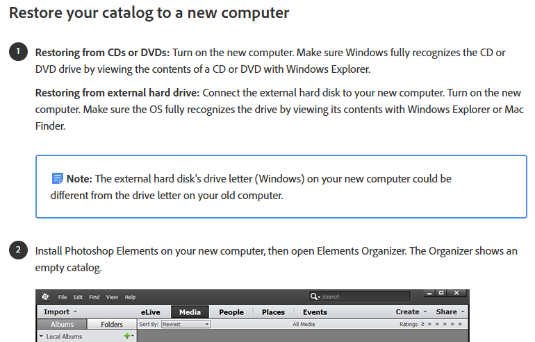

Greg, I still have the crashed drive and would love to try a service to retrieve the photos. If you have any you could recommend, I would grately appreciate it.
Thank you for your reply! This give me hope! Would you recommend I create a new catalog before beginning this process? I would then have 3 catalogs which is fine but just checking if I should proceed with a fresh catalog? And to be sure I'm at the right stop, is the below image pointing to where I should begin?
If this works for me, my next step according to what you have above is to bulk import them into my existing catalog. Is there something online that takes me through this process?
If this all works, the second catalog will not be of importance to me. I've only kept it in case I can ever retrieve these files. I appreciate your final thoughts on if my old catalog contains thumbnail previews. I will certainly consider this! I am so hopeful! Thank you for your reply!
Dec 26, 2024 Dec 26, 2024
I don't have any recommendations for a disk restoration service.  It has been many years since I used such a service.  I'm sure a Google search will retrieve many.
Yes, I think you are starting at the right place.
There is no need to create a new catalog for the restoration of your backup.  The backup will restore a copy of your old catalog in its condition at the time it was backed up.  However, it would be good idea to backup your current catalog in its present state.  It will be useful if something goes astray when you do the bulk import from the restored catalog.
Once you restore the backup, perhaps you will be able to tell which folders contain the missing files. For example, if you have your folders organized by date or some other scheme.  If so, it will be relatively easy to import the missing photos into your current catalog.  Let me know, and I will walk you through the process.

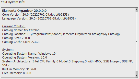

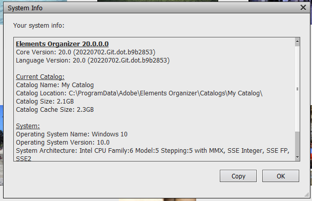

APE System Information.pngI've not done a zipped folder before. I don't suppose you can walk me through that? I could look it up on Google too.

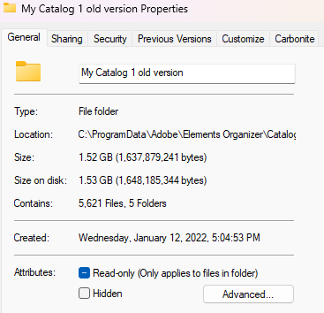

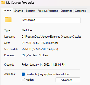

Also, this is what My Catalog and My Catalog 1 Old Version properties look like. Should I copy both? My Catalog Old.pngMy Catalog Contents.png

Your last screenshot truncates the full path of the two catalog folders.  Can you show a screenshot of the folders in Windows Explorer.  It's possible that the old catalog is within the new catalog's folder.  If that is the case, you should probably clean that up before proceeding further, although it may not be a big deal.  If one folder is within the other, please show screenshots of the contents of each folder.
Before making a backup of your catalog, open the Organizer and select Find>All Missing Files to determine whether any catalog files are missing.  If there are any, you must either reconnect them or delete them from the catalog.  Otherwise, the backup will almost certainly fail as it did with your  first attempt.  I als recommend that you Repair and Optimize the catalog in the File>Manage Catalogs dialog.  Proceed with these operations even if you get a message that no errors were found.
Your current catalog is very large.  It's one of the largest I have ever heard of (and mine is close in number of media files).   So any copy operation is going to take a long time.  But that is why I suggested zipping the folders before copying them to another drive.  Since the zipped copy will be added to the current drive, you have to have enough room on the drive, particularly if it is the system C drive, with at least another 10% of free drive space to spare.
I assume your computer is Windows 11.  If it is, there is an easy way to zip the catalog folder.  In Windows FIle Explorer, right click on the folder and choose Compress to. . . .  from the context menu.  A sub-menu will open and you should choose ZIP.  A new file will be created which you can rename if youi want to, but that is not necessary.  Just make a note of the proposed name so you can find it again.  If you don't see the Compress to option shown in my screenshot below, then select the Send To option from the context menu and choose Compressed (zipped) File.  (I have other zipping software installed so I'm not sure what the Windows options are.)

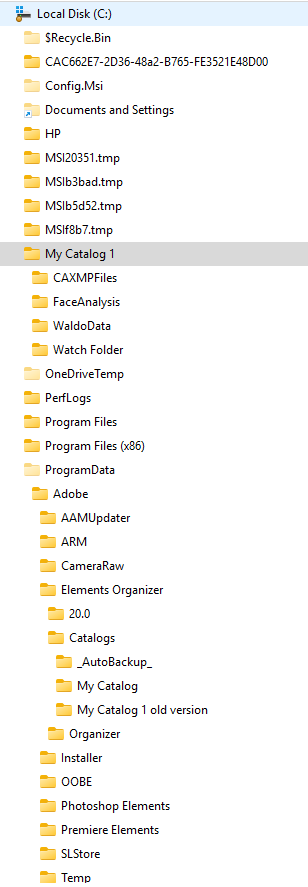

Below is a screenshot of my Windows folders. I am running Windows 11. I did reconnect all missing files prior to the attempted backup, however I did not to the Repair and Optimize. That has now been completed on "My Catalog". I will run these on the "My Catalog 1 Old Version" next.
Dec 31, 2024 Dec 31, 2024
OK.  So, your old catalog is in the default location and your current catalog is on the root of the C drive which is fine.  Here are my answers to your other questions:

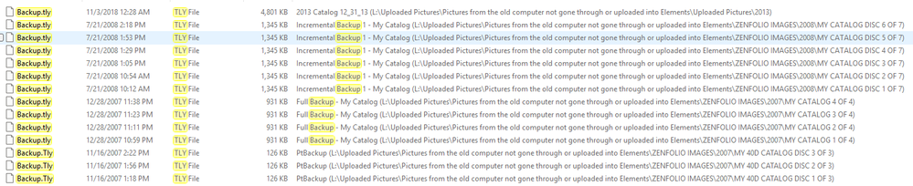

4. I've found multiple .tyl files on my computer. I didn't name these well (some I did; others not). I'd like to see if I have photos I've lost from the hard drive fail years ago in any of these .tyl BackUps. Can I do a RESTORE of all these .tyl files? Do they have to be done in a certain order (I have 14 dating back to 2008)?
Yes, you can restore every backup you have made to see whether it contains the lost photos.  But, make sure that you are not overwriting any files.  I think I would start at the latest and work my way backwards.  If you always had your photos in a single catalog, any missing photos will be in the backup you created just before the hard drive crash.

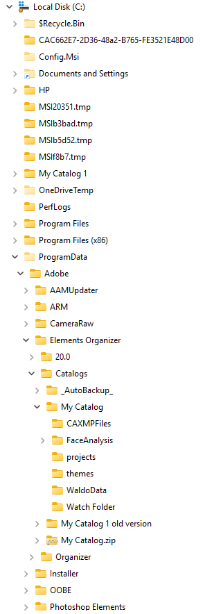

1. I agree on the extraordinary amount of time it took! I did NOT copy any of my photos; only the My Catalog folder. Could it be because the zipped folder was being extracted from my external HDD/NAS which I have on another level of my home? Below I have explained better the drive letters I use.

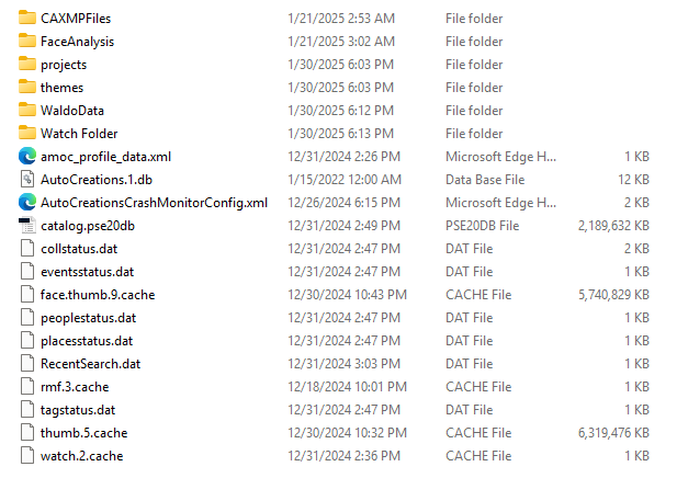

I went to the PSE2022 default location for My Catalog on my internal HDD/C drive and zipped that folder, copied the zipped folder to my external HDD/L drive (I have two external HDD on my NAS that have been set up as redundant drives - I treat the 2 drives as just one External HDD although one is named L and the other M).  Below is a hierarachy of my internal HDD/C drive. It still appears this way. I have not deleted anything.
Below is what is inside the unzipped folder I copied over from my internal drive/C drive to my external HDD/NAS

The catalog files are presumably within catalog folders.  These are the main database files. The number within the file name denotes which version created the catalog.  From Elements 2018 to Elements 2023, the numbers skipped the dates.  So, in your case, the file catalog.pse20db was created by Elements 2022.  The numbers now follow the calendar years.
It is unlikely that these old catalogs will help you find the missing files, since the photos are probably in a different location than when the catalog was in use.  But if the full catalog folder is available, you might be able to use the technique I mentioned previously and take a snapshot of the single image view thumbnail of what will be a missing file in the Organizer.
In order to open the catalog, in your current version of the program, go to File>Manage Catalogs and click the Convert button.  You will then navigate to the catalog folder and the old catalog should then be listed.  Select the catalog and click the Convert button in the navigation dialog.  The catalog will be converted to that version and a copy of the old catalog will be saved.

3. I have images named B000XXX, etc in 'My Catalog'. What did I do wrong in previous RESTORE processes to get these low quality images in 'My Catalog' and is it still possible to find/retrieve the higher quality version of images if they are still on my computer?
Files named with a B00 prefix are the backup copies of the original files in the backed up catalogs.  If these are old files, perhaps they were not high resolution to begin with.

I'm also including a screenshot of my PSE2022 System Information, the old .tyl files and .buc files I've fund on my external L drive in case that helps. I do not have as many .buc files as .tyl files, and I'm guessing that will also be an issue with retriving these lost images?

So it looks like you have copied just the catalog folder to your external drive(s).    This ensures that all your tags and face recognition etc. are backed up.  And if you are copying over a wifi connection, this would explain the slow transfer.
Please explain what you mean when you say your L and M drives are set up as redundant drives.  Are they set up as a RAID drive?  And, if so, what kind of RAID?  If this is not a RAID configuration, how are you keeping the drives in sync?
At this point, it seems to me that you have a sufficient backup of your current catalog and photo files.  Your focus should now be on trying to find the lost files. You may have copies in the full backups that you have created over the years.  So, you should restore the backups you already have, starting with the most recent one created before the hard drive was lost.
When you perform the restore process, create a new folder location for the files to be stored in, e.g Backup Photos folder 1.  That way the photos can be stored in a dfferent location than your current catalog and you will avoid confusion.  If you find  any of the the lost photos in a restored catalog, you can then copy the file to your current photo storage folders and import them into your main catalog from there.
@amyvegte said:  I’m not quite following what you mean when you say ‘the catalog files are presumably within catalog folders’ – are you saying that each of these .psedb contain only database files? If so, then perhaps these catalog files are no longer pertinent as I have done upgrades over the years and previously converted them (at least I think I have; hard to remember). Is there any harm in re-converting them to check out what you previously mentioned and take snapshots of single images? Guessing that they can then be deleted from my internal C drive or is it important to keep these?
The catalog.pseXXdb files are the main database files used by the Organizer.  They are contained within folders that bear the name of the catalog that created them.  (You can change the name of the folder and the catalog's name will be changed.)  There are a bunch of other important files within the catalog folder.  For the most part, if these other files are missing from the folder, they will be automatically recreated.
There is no harm in re-converting a catalog that has been upgraded previously.  However, if the catalog has been previously converted by the current version's Organizer, you will need to check a box that says something to the effect of look for previously converted catalogs.
Catalog folders are relatively small.  So, I always keep them.  You never know when they may be needed.
@amyvegte said:  Since I’m wanting to recover the actual images, do I need to get those from the .tly files instead? I have multiples of those on my external HDD/L drive.
A .tly file is a very small file that contains imortant information about the backup.  So, yes, if you have any hopes of recovering the lost files from a backup, you must restore these backups.
So that I understand, is the .tly files the file that contains the photos that get restored? The .psedb20 has only the catalog information store (i.e. tags, face rec, etc) and the same with the .buc file?
