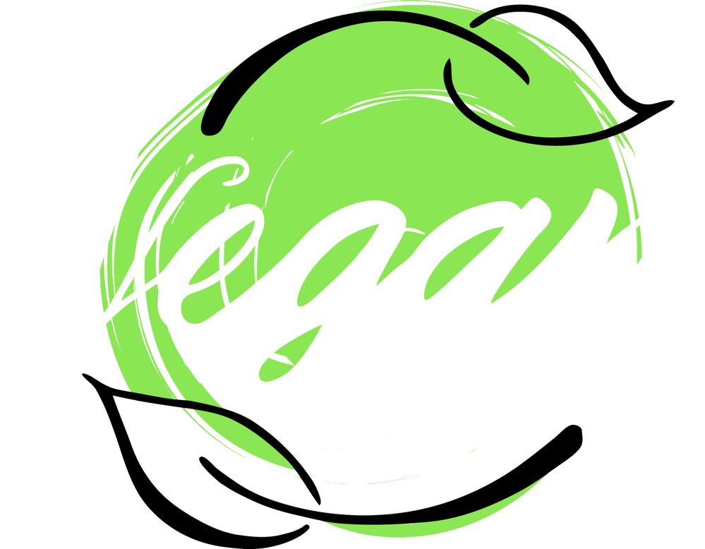

How accurate do you have to be with the lassoo. I've tried to do this and ended up with this imageScreen Shot 2020-02-29 at 13.47.11.jpg

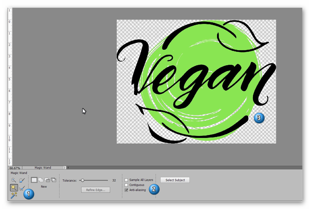

I have moved your post to a new thread so it is more visible on the forum.  As hatstead has suggested, it would be helpful to see the whole before image.  However, it is likely that you will be better off using a different tool such as the Magic Wand (1) to select all the white pixels.  Uncheck the contiguous box (2).
When you delete the selection you should be left with just the non-white pixels on a transparent background (3):

I'm multitasking at present, cooking dinner, washing up etc and have just got back to PSE. My last reply was in response to a request from Halstead to show the image before manipulation. I have now tried the magic wand and ended up with this:delete attempt.jpg
