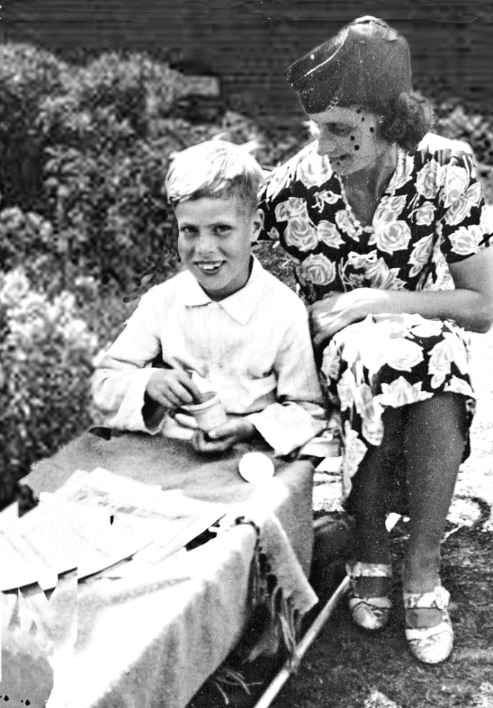

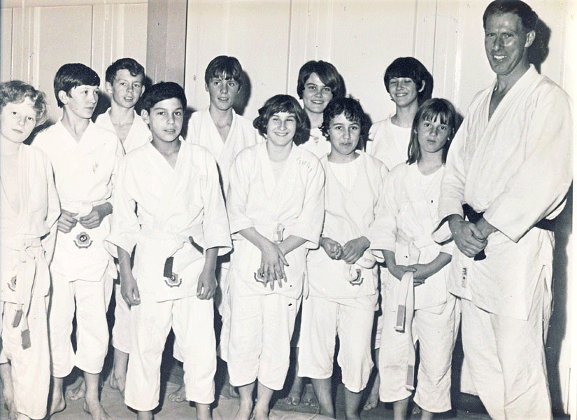

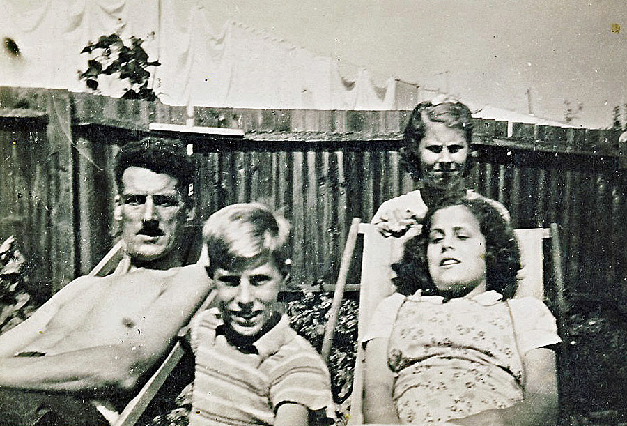

I've attached four b/w photos together with the same 'colourised' pictures.
In the judo group with trophies there is a lack of colour on the faces of the two children on my immediate left and a couple in the back row.
In the other judo group the colour is ok on the right but fades almost completely on the left, and some of the legs & feet are also colourless.
In he photo of me in a hospital bed the colour is mainly acceptable but my and my mother's hands are colourless.
In the family picture the overall colour is very poor and my sister in the deckchair has no colour at all.

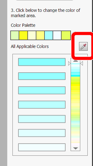

Now, you may find that the color palette that is available does not hold acceptable colors to use.  In your case, this would be skin tones.  The solution is to use the eye-dropper color selector to pick a color/hue that is already in the photo.
Here, it is important to zoom into the area of the image containing some skin, because there may be shades of pixels containing colors that are too dark or too light, or the wrong shade.
If you select a pixel that doesn't work, you can always click again and the colorization will change dynamically.

I have used both the auto-mode and Manual mode, sometimes switching backward and forward on the same project.  One point that has puzzled me is that sometimes the eye-dropper tool is apparently not available; could there be a reason for this, am I perhaps doing something wrong?

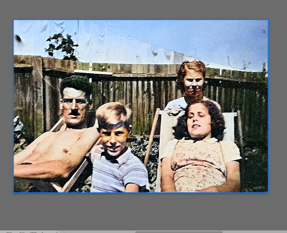

I have created a video tutorial to demonstrate my approach to fixing the skin tones on your photos. I used one of your photos that I had not worked on before, and I created the tutorial on-the-fly without any preparation.  So, it is a little rough.  Hopefully, it will give you some ideas for fixing your black and white images.
For those who don't want to watch the tutorial, here is the photo with Jim's original result and my colorized photo.  BTW, I have also added a blue sky manually, which is not shown in the video.  I tried using Elements' Guided Edit to add the sky, but the photo did not have sufficient contrast with the washing on the line for the AI to get a good result.

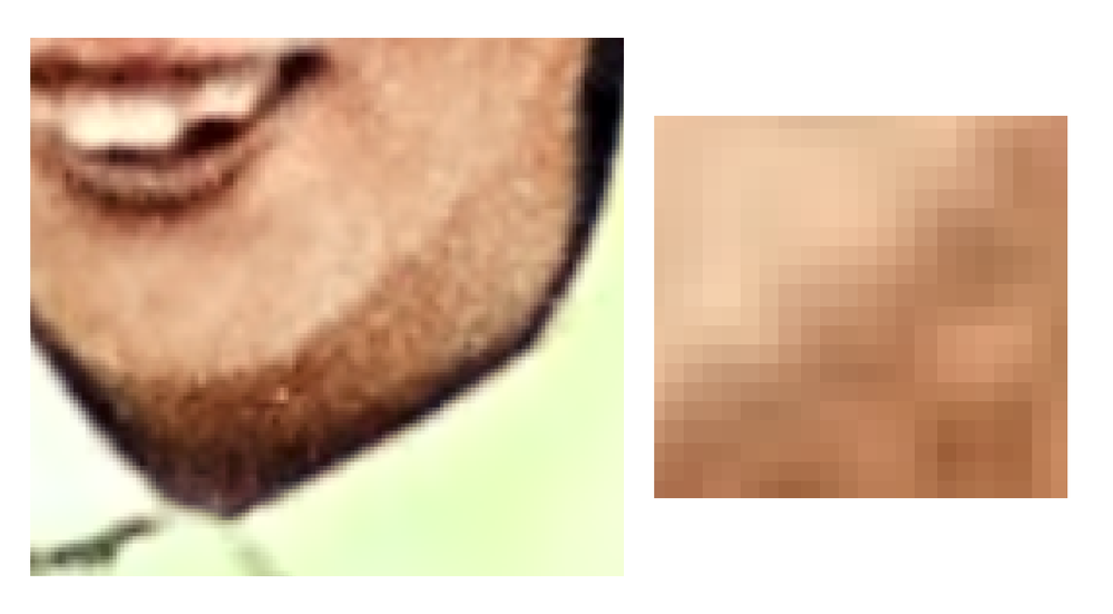

And, while I try not to spend other people's money, I thought I would give you an example of what the latest colourization filter in Photoshop Creative Cloud can do.  I created the following by simply using a single adjustment slider to add more saturation than the automatic version created by the program.  You said you have a lot of B&W photos to colourize.  It may be worth your while to subscribe to the Photographer's plan ($9.99 in the US) for a few months to use the better tool available in Elements' big brother, Photoshop CC.
I found it interesting that the AI picked similar colours to me for the shirt and dress.  And while this example is also not perfect (note the chin of the boy), you can edit it manually too.
