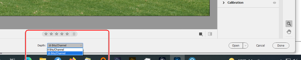

The Elements version of ACR will work in 16 bit depth.  You can switch from 8 to 16 bit at the bottom of the ACR dialog.

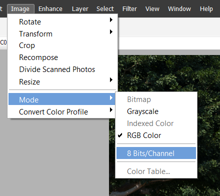

Snap_2021.10.18_11h59m4s_003.pngThe Editor can also edit a 16 bit file.  BUT, there are some limitations on which features will work in 16 bit.  If a feature does not allow 16 bit files, a warning will show up and you will be given the opportunity to convert to 8 bit.  You can also switch between the two in the Image>Mode menu:
You haven't told us how you want Lr and Elements to work together, so I can't comment further on that subject.
