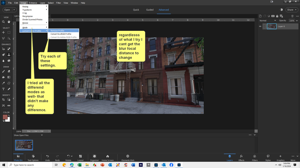

I'm not sure if this will help, but try going to Edit>Preferences>Performance and change the Use Graphics Processor settting:

To use the Blur Focal Distance, one needs to set the Depth Map Source to something other than None.
