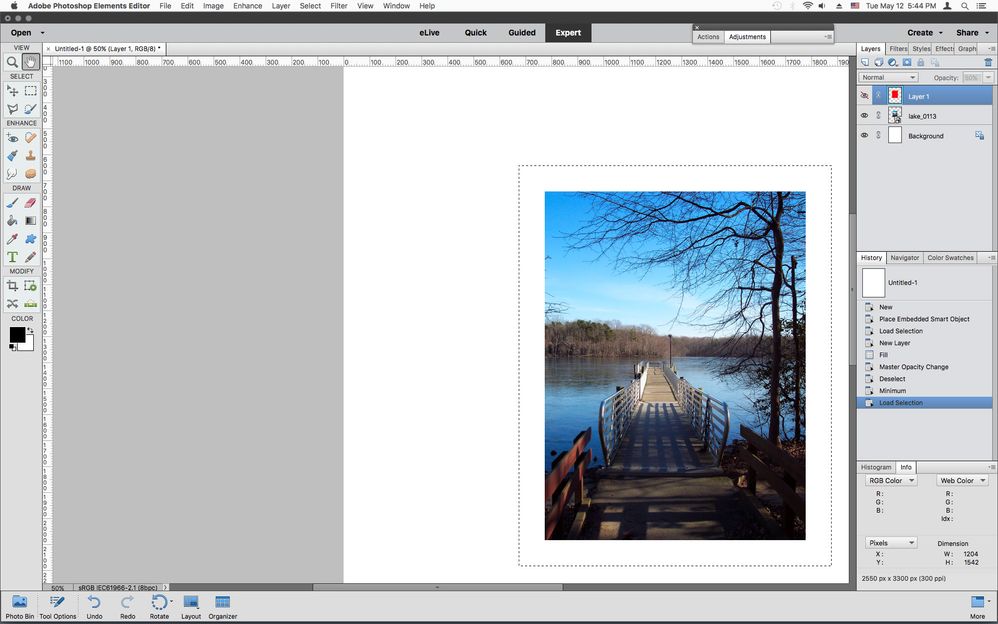

Here's another thing to try:
1. Make the selection of your photo
    (Cmd or Ctrl click on the Layer Thumbnail in the Layers panel)
2. Make a New blank layer above the photo layer
3. Go to Edit>Fill>Color and select a color of choice
4. Set the Layer Opacity to 50%
    (not necessary unless you want to see your photo)
5. Go to Select>Deselect
6. Go to Filter>Other>Minimum and set the amount to expand the selection.
     (for 100 px enter 100)
7. Then you can turn of the fill layer or delete the layer to see yor selection.
New Here ,
May 13, 2020 May 13, 2020
I tried your sugestion step by step and the result is exactly what I was looking for!
Filter>Other>Minimum enables me to enlarge a selection by a number of pixels (instead of %) without cutoff corners. Clever use of the filter functionality 😊
I figured out that if the purpose is cropping, then the method of “Select > Modify > Expand” will still be the fastest way of doing. This is because cropping is always done in a neat rectangular shape, and will not be limited by the cutoff corners of the enlarged selection.
But if you don’t want to crop than Jeff_Arola’s “filter” solution (allowing # pixels enlargement of a selection) is much better.
