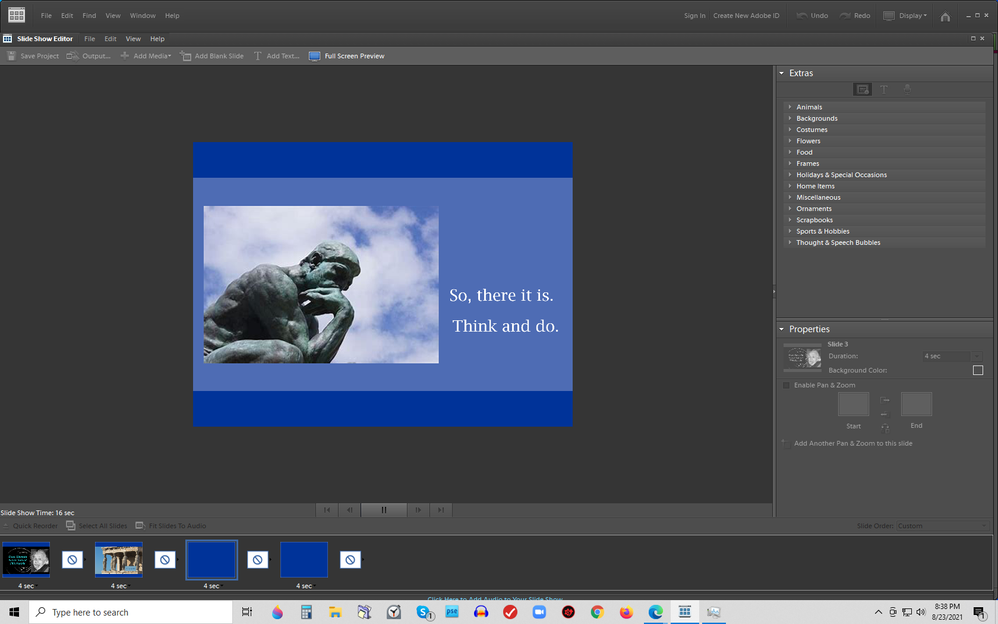

     I'm running Photoshop Elements 8 on Windows 10 (64 bit, 8 gigabytes of RAM).
     I'm trying to make a slide show for Youtube;  it's about an old math puzzle called "How old is Ann?"
     Some of the slides don't show up on the storyboard at the bottom of the screen..  They appear blue, which is the background color I selected.  I managed to work around the problem for a while since the slides do show up on the center screen when I click on the Play button.
     Today, I tried to output a wmv file of the entire slide show.  The "movie file" that this produced seemed ok for a while -- until it got to the problem slides -- they did not show up, or rather, they appeared as blue screens.
     I tried inputting the slides as jpg files and as png files (and, if I remember correctly, a couple other file types, too).  Nothing worked.  I worked on the slides in the Photoshop Elements Editor.  Some slides that look similar to the problem slides do show up in the storyboard.  I can't figure out what the difference is.

     Thanks for replying so soon.  I have tried to input those slides into a new slide show, but I get the same results.

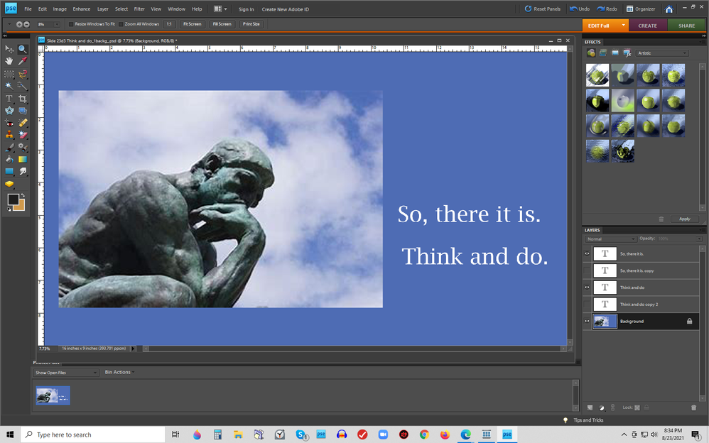

     I just tried it again with four slides.  The first two were slides that "worked" before -- Einstein is a PNG and the Greek temple is a JPG file -- they worked again.So there it is_jpg_png_.png
     The third slide, which did not show up in the storyboard, was a JPG of Rodin's Thinker  I went back to the original PSD file of that slide and saved it as a PNG file for the fourth slide -- that did not help --  it did not show up in the new slide show's storyboard either.

     I figured out why some of my slides were not showing up when I output my Photoshop Elements 8 slideshow to a WMV file.
     It had to do with pixel dimensions.  When I started putting my slideshow together, I set the dimensions for each slide at 16 inches wide by 9 inches high, because as I understand it, YouTube wants a 16 by 9 ratio.
     After I worked on each slide and saved it as a JPG file, I saved it with Image Quality 5, a medium setting.  I figured:  not too big and not too small.
     For most slides that worked well, but some slides were saved with huge pixel dimensions, such as 16000 by 9000.  I don't understand why that happens.  Those slides would not show up on the Photoshop Elements 8 Organizer Slideshow storyboard -- they appeared as a blue screen there (I had picked blue as my background color).  The same slides DID show up when I clicked on the Play button, so I put up with the inconvenience until I finished the slideshow.
     But then, when I "Output" the slideshow as a WMV file, those same slides showed up as blue screens.
     I tried saving the slides as PNG files, BMP files, you name it.  Then, by chance, when I was searching through the folder that all these slides were in (using Large Icon mode), I happened to hover over one of the problem slides.  I noticed "Dimensions: 16000 x 9000", and I wondered what the dimensions were on the slides that worked properly.  They were much smaller. One was 7077 x 3981;  one was 471 x 265.
     So, I tried to figure out how to reduce the number of pixels for each problem slide.  I found one simple way -- using Microsoft Photos.  In the folder containing all the slides, double-click on the slide's icon.  It will appear in Microsoft Photos (unless you have somehow changed your preferences).  Click on the three horizontal dots at the upper right of the screen.  Click on "Resize".  Click on Option L -- "Best for viewing -- 4MP."  Select the proper folder;  rename the file;  click on Save.
     The slides I did this to show up on the storyboard.  I first tested outputting four of them to a WMV file, and that worked.  And now I have just output the entire slideshow, and it works!
