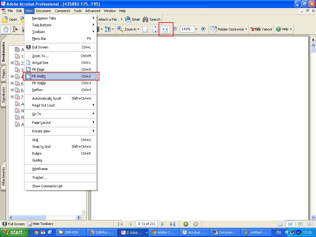

I am used below Post Script code to set the PDF Initial view Magnification be Fit Width but it won’t work.
[ /PageMode /UseOutlines /Page 1 /View [/FitB] /DOCVIEW pdfmark
But when I am tried for Fit Page it will work
Script for Fit Page (Working)
[ /PageMode /UseOutlines /Page 1 /View [/Fit] /DOCVIEW pdfmark
Script for Fit Width (Not Working)
Note:

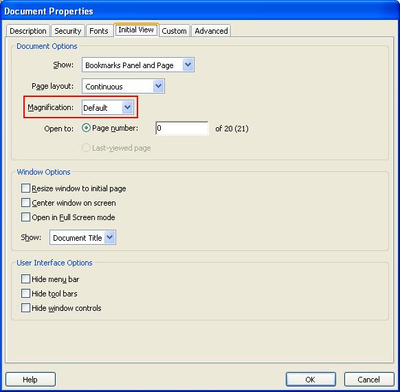

When I am tried in alternative way with help of {Catalog}  /PUT pdfmark the Fit Width will work but not updated in Initial View  Magnification field. But Fit Page will work and also updated in the Initial View  Magnification field.
Script for {Catalog} Fit Page:
[ {Catalog} <<View [/Fit]/Page 1>> /PUT pdfmark
Script for {Catalog} Fit Width:
[ {Catalog} <<View [/FitB]/Page 1>> /PUT pdfmark
When I am open this same PDF in Adobe Reader the zoom level will be in FIT WIDTH only for {Catalog} Fit Width.
Screen shot for Fit Page.
Screen shot for Fit Width.
From the above screen shot I am marked in red color for your clarification,
I hope you all understand my problem.
So please give solution for this problem.

ok any way i am got solution Test Screen,
Here my postscript script:
[ /PageMode /UseOutlines /View [/FitH -32768]/Page 1 /DOCVIEW pdfmark
[ {Catalog} <</ViewerPreferences<</DisplayDocTitle true>>/PageLayout/OneColumn>> /PUT pdfmark
Above postscript code was i am used to get my PDF Document Properties - > Initial View as
Document Option
  • Show: Bookmarks Panel and Page
  • Page Layout: Continuous
  • Magnification: Fit Width
Window Options
  • Show : Document Title
I hope my statement is true because it working.
