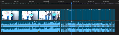

I am getting this error in the beta 25.4.0 build 83
All I have done to generate this is drop the warp stabilize effect on 3 clips, turned on detailed and turned off fast.
the error appears a short time after the the clip starts to analyze for warp stabilize.
Not sure  if the timeline itself is generating this error when it draws the thumbs, or the warp stabilize effect is generating it as it processes the clips.
CPU and GPU are not very busy when this happened, or SSD's
In this state while warp stabilize is running, premier is highly non responsive on Time line scroll, other windows are performing fine.   If I move to a place on the timeline where none of the clips I have warp stabilize working on, the timeline returns to normal performance, and can play video smooth in the program monitor also.
it seems that the thumbs for the time line stopped drawing after these errors appeared:  I had continue thumbs on at the time, but I changed it back to show head and tail only when this screen shot is taken:
If I zoom into the time line more the heads or tails still don't redraw:
