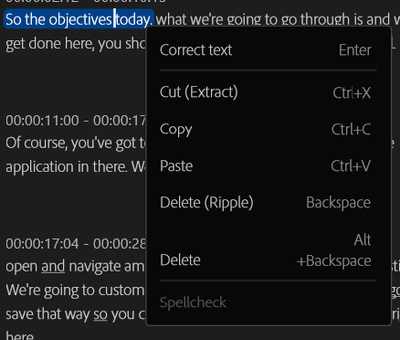

So when I right click here is what I have.
I have the shortcut keyboard set on default.
What is happening is when I highlight text and right click and select ripple delete the highlight text has in and out point created on the sequence, but then only the playhead moves to the begining of the selected text. with no deletion. If I do the same thing as above, but select delete, nothing happens.
Community Beginner ,
Dec 21, 2023 Dec 21, 2023
it seems the only thing working in the drop down list is EDIT TEXT

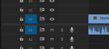

Edward,
Sorry, I did not see it the first time: the tracks to be effected must be targeted (e.g. the V1 and A1 must be lit up).
If you have content in tracks that are not targeted, it will delete but not ripple delete. Since NONE of your tracks were targeted, you saw nothing happen.
While this "should" explain your situation, I'll just say that in the samples I was testing, I have no problem in one sequence, and in another sequence, I see only "Correct Text" in the right-click drop-down in the Text Panel, Extract and Lift are greyed out, but Extract/Lift in the Program Monitor works. They are both simple sequences with a single clip with a Source transcription.
Stan
Ding DIng!!! That was it!! Once I highlighted these tracks it began to work again perfectly! Thank you! I knew it was a small oversight somewhere. Here's a snippet incase someone else finds this thread in the future.
