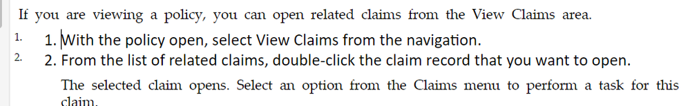

Hi, Peter:
I checked out the autonumbereing/lists instructions on your site for RH2020. Screenshot 2022-04-14 082913.png
This is the second list in this topic, so if I applied autonumber, the second item was numbered as 5. I took off autonumber and applied the numbered list style from the toolbar and got the above. I can easily change the fonr to match the correct text, but why do I get the tiny numbers on the left?

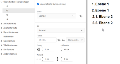

I struggle with the same question - and find this a strange solution.

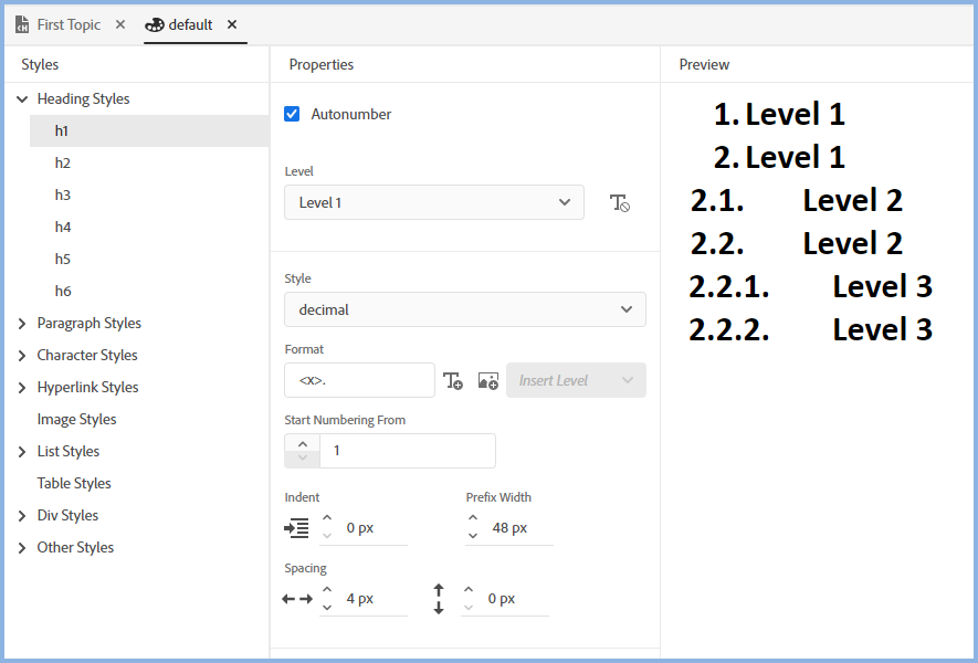

What I would have expected is:
H1 = Level 1 = 1..., 2..., 3...
H2= Level 2 = 1.1, 1.2, 1.3, ...
H3= Level 3 = 1.1.1, 1.1.2, 1.1.3,...
When setting the Autonumber formats in this way, the preview shows the correct structure:
When publishing a PDF it does not work.
I use different css for online and PDF: online without numbering, PDF with numbering.
If I would follow your way using always h1, how do I tell the lower level headings to be a lower level when using the online-css while creating content?
Thanks for your really needed help

May 23, 2022 May 23, 2022
If you are using autonumbering you only need to define H1 with however many levels you want. You define the appearance of each level separately so you would create Level 1 to look the same as H1 looked without numbering, then you define Level 2 to look like H2 would without numbering.
That way you end up with say 3 levels. In this example I have just changed the font size at each level.
Before I changed the font sizes to illustrate that point, I generated an online output. Each of the headings is H1.
1 Fifth Topic is from just applying H1 to the text.
1.1 is from applying H1 to the text and pressing the tab key once.
1.1. is achieved by pressing the tab key twice.
You don't need H2 for the numbering. Only H1 has been used here.
However, in PDF that came out as below.
I have asked Adobe if they can advise me what is wrong here. I will post back when I get a response.

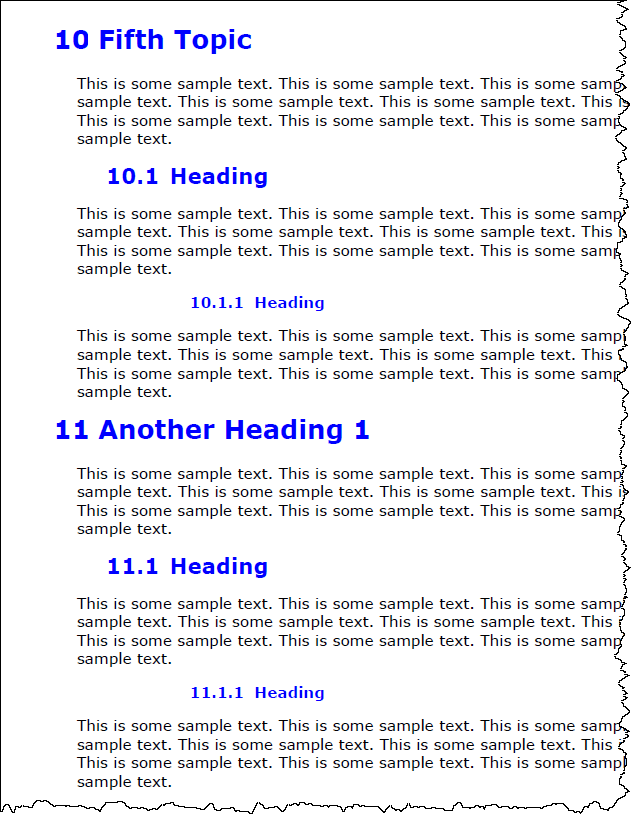

May 24, 2022 May 24, 2022
I had erroneously applied a second CSS to my PDF causing a conflict of styles. With that removed I got what you see below with autonumbering working as designed.
"10" because this is the tenth topic in this particular TOC, notwithstanding its name. I also tested using Restart Numbering against the first heading and that worked fine.
"11" is a second heading in the same topic.
This was done using H1 with three levels applied. I understand why H1 with three levels gives you issues online but this is how autonumbering works.

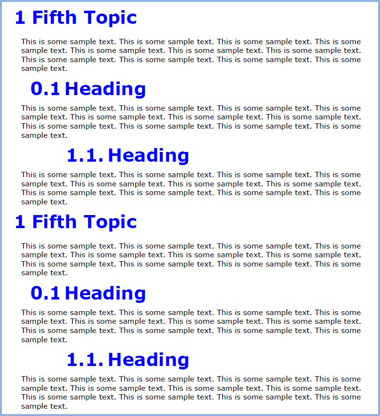

Well if I try the way you suggested with the h1 headings, following happen:
Have you tried your example adding more level 2 and level 3 headings?
This wrong numbering is already in the editor and also in the PDF output. And in this case all headings are placed in one topic. When publishing several topics it is the same wrong numbering: Level 1 headings are numbered correctly, level 2 and 3 headings start with ...1 but are not incremented.

For this example I used a new blank project and just set the h1 as discussed. Indeed I wanted to be shure, that not any other side effects will cause the trouble. Thus, not much chance to do it wrong.
There are two issues, the positioning and the incorrect numbering.
Positioning
That was down to your configuration.
Level 1 was OK as shown here but not the other levels.
Note your settings under Indent, Prefix Width and Spacing. I changed them as below and that got Level 2 to where I would expect to see it.
Then I changed Level 3 as shown.
Thus to get the levels as you want, change those settings.

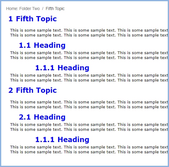

Numbering
That was more tricky and I think there is a bug, which I have taken up with Adobe.
If you create a new topic and set this up, then apply H1 all the headings will be Level 1, obviously.
Then tab Level 2 once, it will show 2.1.
Tab the first Level 3 twice and it will show 2.1.1.
Tab the second Level 3 twice and it will show 2.1.2.
The bug is that if you enter other content after each heading, then create the next heading and so on, the numbering goes wrong.
I will let you know what Adobe come back with or if I find a workaround.

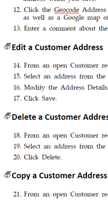

I probably should have started my own thread. I want a list of steps to carry out a procedure. For example,
1. From the blah blah, select blah.
2. Enter changes on the blah blah screen.
3. Blah blah
I have styles set for List Level 1, and separate styles for List Level 2-9 and List Level 10. I'm having trouble with the numbering in a topic. If I have two lists in the same topic, the second list continues the numbering from the first list. For example, if the first list had steps 1 through 8, the second list shows as starting with step 9, because it is continuing numbering from the end of the first list.
I was reading on your page about the differences between autonumbering and ordered lists. Is it possible I am mixing these up?

I think I have a solution for your online output.
Configure your levels for the autonumbered CSS so that Level 2 and Level 3 are styled to look like H2 and H3. The editor lets you apply different fonts, sizes, colours for each level.
Then duplicate that CSS and in the autonumbering configuration set the Style to None rather than Decimal. The numbering will disappear. You will need to adjust the positioning.
Use one CSS online and the other for PDF.
Would that work for you?

Adobe have come back to me with a method of making this work with H1, H2 etc but it gives rise to some questions that I have gone back with.
Once I have their reply, I will document the method.
________________________________________________________
My site www.grainge.org includes many free Authoring and RoboHelp resources that may be of help.
Help others by clicking Correct Answer if the question is answered. Found the answer elsewhere? Share it here. "Upvote" is for useful posts.
May 26, 2022 May 26, 2022
I'm sorry to say the method to sent to me was based on a misunderstanding about the requirement. I found issues that I went back and forth on and once the misunderstanding had been clarified, Adobe confirmed my method is what you need to use in 2020.
That leaves us with the bug and I have asked if there is a workaround for that.
The good news is that working the way you want is being considered for the next full version due later this year.

Hi Peter,
have you heard anything more from Adobe? I am working with RH 2022.0.346 and I have toyed around with RH's autonumbering and the counter-reset and counter-increment functions, and it is still messing up my PDF's heading numbering.
I have two outputs: HTML and PDF, same content, different CSS.
For my HTML output, I am working with our company's css - I cannot change anything there (especially not h2...h5 to different h1's with different settings). I need to stay with h1...h5 and, for my PDF, need a working numbering (as our customers print the documents).
