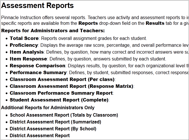

For reference, here is a screenshot of the topic in Firefox 12 from my colleague's laptop with hardware acceleration enabled.
Here is a screenshot of the topic in Firefox 12 with hardware acceleration turned off.
I'm not sure what the HTML/CSS specifications say about how the double bold formatting markup should be interpreted by browsers. Mozilla doesn't seem to consider this a bug.

Your images are the same size but note that the words at the end of the line starting "Pinnacle" are different. That suggests the issue is to do with the zoom level the two machines are set at. Check that out.

this is interesting. I disabled hardware acceleration and the text appears as it should. All bold things have the same appearance - that is what I want.
Screenshot (disabled hardware acceleration):
Screenshot (enabled hardware acceleration):
Both have same zoom in Firefox 12, in version 11 it looked the same.
