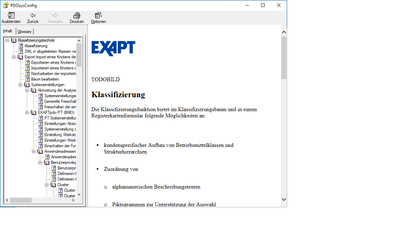

The TOC in the author section is not the same structure than the structure (TOC) of the output.
This is the structure of the output:
This is the structure of the TOC in the author section:
As you can see the it is much different. For example:
The folder "Systemeinstellungen" is not on the same hierarchy  than the folder "Klassifizierungstechnik". The folder is inside the folder.
But you can see, that this isn't the case in the TOC in the author section. Both folders are on the same level in the hierarchy.

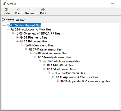

I have the exact same problem. I had a project working fine in Robohelp 2012, then I upgraded it in Robohelp 2020.2.29. The TOC file looks the same in 2020 as in 2012, but after generating the output in 2020, the generated chm file has a totally messed up folder structure and lots of topics/sections missing.

I auto generated a new TOC, see picture below (there are pages in all sections, but I’m only expanding the section with a few pages):
The generated chm file still has incorrectly nested sections. At least all sections seem to be included here, that is not the case in the TOC that was generated in a previous version of Robohelp and converted to this version.
