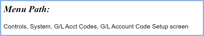

Normally, the "In This Topic" section of the Frameless output has links to the H1, H2, H3, and H4 styles, and links to them as such, without using bookmarks. See an example of the filepath/webpage URL that pops up for a normal topic when clicked in the "In This Topic" section.
Now, see below an example of the page that is failing. I believe it is throwing Error 403 Forbiddens to our customers because it is using bookmarks (and incomplete ones, at that) to try and call the section of the page.
How do I fix this?

It is the italics and the link in the header that did this.
Removing the italics from H2 and the outgoing link that was H2 solved the problem.
Seems like it was a RH issue.

Right, I added in to the test file and uploaded it to a sub-section of our network and the clicked links do work in your file - but they are not italicized, so they would!
When I add a new header (H5) and add it to the 'In This Topic" output, but have italics as part of the style, it works.
Like Jeff just theorized above, the inline italicization hurt the html, because it altered the (H2).
With a new (H5) as a copy of (H2)+italics in the setup, it is all good.

Ah - inline styles can be a recipe for trouble - better to edit the CSS and add formatting to it to be applied as a regular style.
Explorer ,
Jun 26, 2025 Jun 26, 2025
This seems like what did it.
I duplicated H2 for another header and included italics in the stylesheet, appreciate your quick help!
