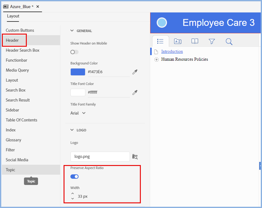

Any suggestions on a setting, file name, location, size that could be causing the logo that appears in the upper left corner to be small? This is when I generate a respsonsive html5 output in Robohelp2022. The file size is the same as what I was using in RH Classic 2019.

Open the template editor and try changing these settings. You may also need to adjust the image itself.

Changing this width to 125 and saving before generating the output worked. Thank you! I appreciate you getting this to the correct forum and for your help here.
