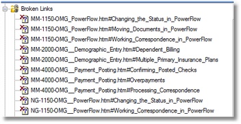

I've noticed that when upgrading RH9 projects to RH10, that RH10 will corrupt (e.g., "Broken Link") all bookmarks set on a drop-down text link. For example, I have a head "Changing the Status in PowerFlow" which when clicked, drops-down a chunk of text. The head is also included as a bookmark, "Changing_the_Status_in_PowerFlow".
These all worked perfectly in RH9 and I've tested the upgrade to RH10 multiple times with the exact same outcome. Bookmarks not associated with drop-down text are unaffected. Note the three MM-4000 broken links, which are associated with drop-downs; there is a fourth bookmark, not associated with a drop-down link, that is accessible:
RH10 inserts a "#" into the bookmark link, producing a "The filename is invalid. The "#" character cannot be used in a path." error. The bookmarks no longer show up in Project Files, but do show on the topic page (with highlighting) and in the bookmark dialog, but the bookmark on the page does not get selected -- as normal -- in the bookmark dialog.
When compiled as a WebHelp project, the bookmarks work as expected. I'm not sure what the correct syntax is for a legit bookmark, and searching for "#Changing..." and deleting the "#" removes the selection from the Broken Links list, but changes no other behavior.
If anyone has any other fixit ideas, I'd be appreciative: I have hundreds of these throughout multiple projects. Thanks...
