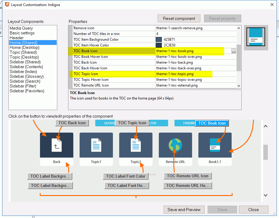

Please let me know how add different images to Book and TOC topics in Indigo layout.
Participant ,
Nov 24, 2017 Nov 24, 2017
Here:
Community Beginner ,
In the screen layout customisation window, under 'Home (Custom icons), you can choose a different image for each icon.
Participant ,
Hi David,
The Home (Custom Icons) doesn't appear in my version - I'm on RH2017 update 2 (13.0.2.334) What version are you on?
Looking at the Adobe website -  2017 Release of RoboHelp (Update 2) – Adobe Technical Communication Blog it says for update 2 that:
"Also, Home (Custom Icons) component in the Indigo layout is no longer available and to customize the landing page icons, you can use CSS route. You can also view the RoboHelp (2017 release) Update 2 readme here."

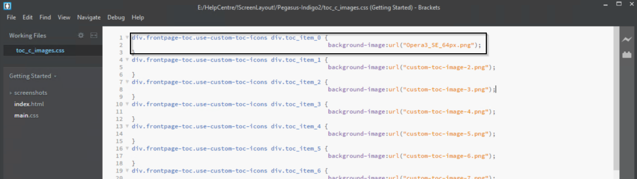

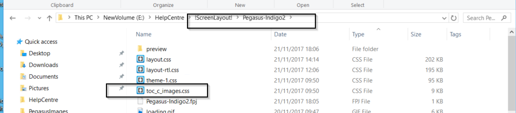

All is not lost though as there is a CSS file which is used (unless they decide to deprecate the entire feature, which would be a nonsense of course). The CSS file is in the screen layouts folder.
Participant ,
That is update 2 you are on. If you add a new layout now, you will probably see the Home (Custom Icons) option is removed.
You must have used that option and then updated to version 2, which is why it is still there.
Yes that looks the right CSS file to change.

The easiest way would be to overwrite the images being used with your own ones.
These are stored in !ScreenLayout!\Indigo1 or can be viewed from the Output Setup under Screen Layouts in Robohelp 2017.
The book image being used on the main page is:
Overwrite this image with your own and generate.
The theme-1.css file references these images.
