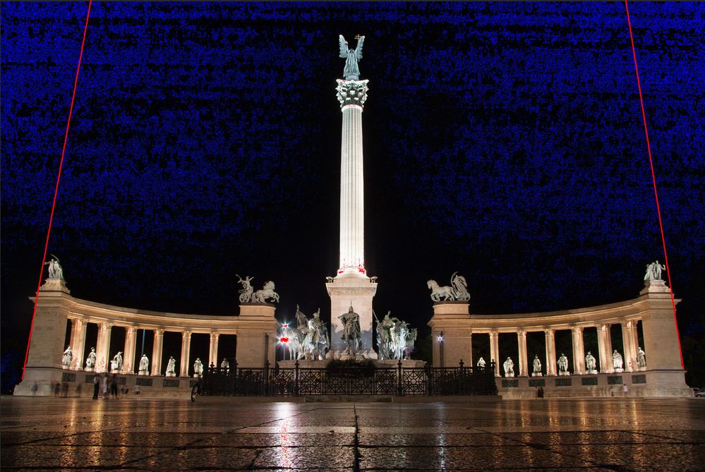

I've just sent in 30 photos, but none of them were approved. Please help what can be the problem with them. I want to learn from the problems. Thank you very much in advance!

'faoletes' -- you need to correct the white balance; it is too green.
gramofonok - perhaps IP (Intellectual Property) issues, composition...
When you take photos for stock, you need to know what you want to shoot and its purpose. What will people use it for? The subject needs to be clear and to show a concept.
For the nighttime shot - again, correct the white balance/colour temperature, as well as the vertical lines on the monument.

Check your histogram. Too much pure black. Also, leaning verticals.

But this is a perspective distortion that I see in a lot of approved images.
I was shooting on the floor, so it's intentional, and it's quite difficult to take a picture with parallel verticals from this position.
Sep 24, 2025 Sep 24, 2025
The leaning verticals issue is probably a matter of how picky the moderator is who is reviewing your assets. Myself, I don't leave anything to chance anymore. Bottom line, it's something that can be corrected.

"But this is a perspective distortion that I see in a lot of approved images.
I was shooting on the floor, so it's intentional, and it's quite difficult to take a picture with parallel verticals from this position."
True, and that's where software correction comes in with photo editing software, e.g. Adobe's Lightroom or Photoshop. The perspective can mostly be corrected.
When taking such shots, bear in mind to give yourself some space so that you can make perspective corrections.

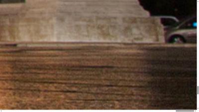

Hi @cs.istvan ,
You need to zoom in on you images to between 100 and 200% to inspect them for issues.
The first image has noise grains, color noise, color fringing, is under exposed and the perspective needs correcting.
Your colors should be smooth.
The second file is also noisy, not sharp on the edges and has a green tint.
The third photo has too much of a high highlights and also has color fringing.
The fourth photo is underexposed and details are lost in the shadows.
Tone done the exposure of the fifth image a bit.
The sixth photo has blur caused by either camera shake of slow shutter speed on a windy day.
