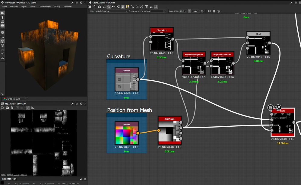

You could try as I've done below:
1.Bake Curvature and Position maps from your mesh
2.Use Edge Select to select the convex edges.
3. Blur those edges 'downwards' using a Slope Blur Greyscale driven by the Green channel of the baked position map ( I used two in series so I got more blur without introducing artifacts
4. Use that to drive the mask input of a leaks node (also with inputs from the curvature and position maps)

'How can I get this result on concave edges?
Same method as above but change Edge Select to use Concave edges
How can I get dirt in the hollow "corners"?
Again a similar method, it is just about creating a mask from the curvature and position masks.
How can I make dirt between different objects in the scene that are touching each other?
One way would be to use a single model with UDIMs for the relevant parts. Then you can use Substance Painters paint across UDIMs https://www.youtube.com/watch?v=YbZvyvhX7PM
I really do recommend using Substance Designer to create materials and Substance Painter to apply them. That way you are working with the strengths of each application.
Dave

Sep 14, 2023 Sep 14, 2023
You could subtract the initial edges from the slope blurred mask:
It is just a matter of using the baked model info withe the nodes to create a suitable mask for the leaks
Dave
