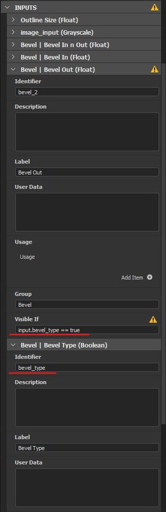

Can you show a screenshot of the input parameter labelling and also the other input visible if entry as below (where it is working here)

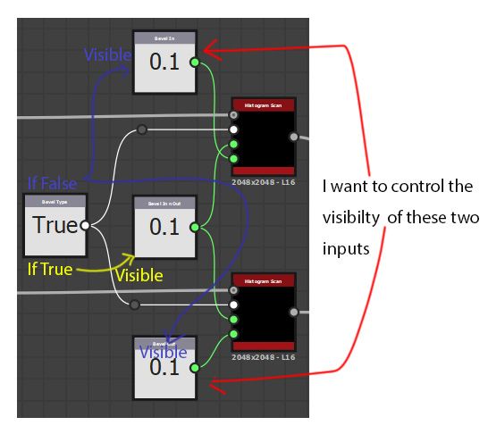

Here's the screenshot:
I want to control the visibility of two inputs (Bevel In and Bevel Out) using the bevel_type input (boolean type).

Apr 24, 2023 Apr 24, 2023
Thanks for the screenshot, now I see the difference between what we were doing.
As far as I am aware, Visible If has to reference an input parameter (in the input parameters section) rather than an input value node.
