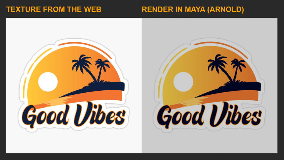

When I download JPG/PNG images from the web and import them into Substance Painter, there's an apparent color shift from the original image. This discrepancy becomes even more pronounced when I export the textures and bring them into Maya, despite both being set to use the ACEScg color space.
Here's a breakdown of my process:
Source Images: These are standard JPG/PNG images directly downloaded from the web. They look as expected in any standard image viewer.
Substance Painter:
  • The color management is properly set up in Painter.
  • On importing these images, the colors appear different than the original.
  • On exporting, I ensure that color maps (like Diffuse/Albedo) are in ACEScg, while other maps (Roughness, Normal, etc.) are set to Utility - Raw.
Maya
  • The imported textures' color discrepancy is evident here as well.
  • The Color Space in the file node for Diffuse/Albedo maps is set to "ACES - ACEScg", and for non-color maps, it's "Utility - Raw".
  • The rendering engine is also correctly set up for the ACEScg workflow.
Despite all this, the color mismatch from the original web image to Substance Painter (and subsequently to Maya) persists. I'm trying to understand if this is a Substance Painter issue or something inherent in the ACES workflow that I might be missing.
That's the issue that I'm getting:
Has anyone faced a similar issue or has any suggestions on why this color shift occurs and how to fix it? Any help or guidance would be deeply appreciated.
NOTE: If I take the image DIRECTLY to Maya and set its color space to "Output - sRGB", the colors get accurate. But when it goes to Substance Painter first and then I export the texture to be used as "ACES - ACEScg" in Maya, the colors drastically change. It seems that Painter is the issue.
To make the understanding easier, that's what I need to know: how do you import images from the internet into Painter and keep its color accurate when using it in Maya as "ACES - ACEScg"?

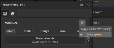

The result you are getting is expected, but that's because you are not using the right color space.
Images coming from the web are very likely in sRGB, especially for png/jpeg (while exr are more likely to be Linear or maybe ACEScg).
If you use our default ACES configurations, 8bit images (aka non-hdr resources) should default to sRGB too. You likely want to keep that setting this way most of the time. Example: color_space_settings_project.png
Now if for some reason you want to import SDR images as ACEScg by default, you can still override the color space of a specific resource from within the layer stack. You need to enable the color space menu first, like so:
Here is an example comparing between the two color spaces:srgb.pngaces.png
For the export, if you want to use ACEScg to load it up in Maya afterward, make sur you use an appropriate image format like EXR or HDR. Otherwise I recommend sticking to png and sRGB as your color space. You can configure this from your project settings.
You can also check out our documentation on Color Management: https://helpx.adobe.com/substance-3d-painter/features/color-management.html
I hope that helps. 🙂

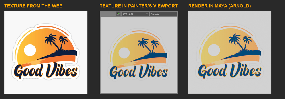

Just to give you a bit more context regarding my previous reply, that's what I meant by "less vivid". Take a look at how dark and dull the texture looks when converted to ACES:
Adobe Employee ,
Sep 14, 2023 Sep 14, 2023
How do you compare the image with Maya ? ACEScg images are linear and meant to be converted into a colorspace suited to be displayed on your screen (that's why you have "ACES sRGB" in Painter's viewport for example.
Also the lighting you use can have an impact as well.

I compare them by simply putting the images side by side. I'm working on a production and usually get complaints due to the artwork that was taken to Maya not looking like the original one that was made in Photoshop by the design team. However, in Maya we're using the ACES workflow.
Also, the render that I showed you is the diffuse channel, therefore there is no influence of any lights or other PBR values.
Adobe Employee ,
Sep 20, 2023 Sep 20, 2023
If you look at Painter's viewport (say the BaseColor/Diffuse channel only) does it looks the same as your original file ? If they match, then I guess it would be a configuration issues when importing/using the file in Maya. I won't be able to help on what to adjust exactly, as I'm not familiar with Arnold.
