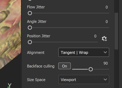

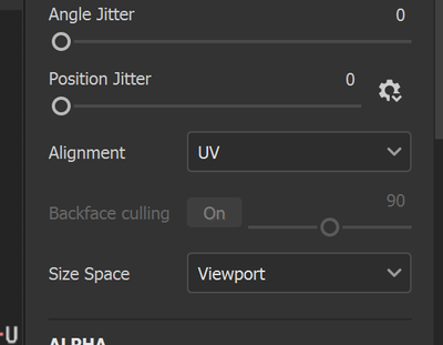

Check your brush alignment is not set to UV make it camera or tangent warp for cloning in 3d view, having it set to UV space gives the effect you are seeing
not UV only use that if you explicitly want to paint in the UV space
Participant ,
Apr 11, 2022 Apr 11, 2022
Tried that. Unfortunately changing Alighnment to camera or tangent warp doesnt make any difference. Any other solution or I have to remake the whole UV?
