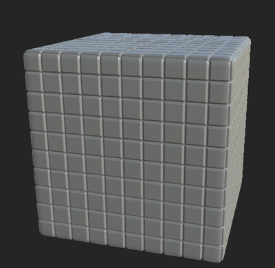

Example below
A plane cube:
A normal map used to add surface details
Top and side viewed at low angle that detail almost disappears as it is not really there:
Surface tessalated and surface displacement driven with height map. Now those low angles have real surface detail so are visible at low angles, but that is at the expense of adding polygons:
Dave
