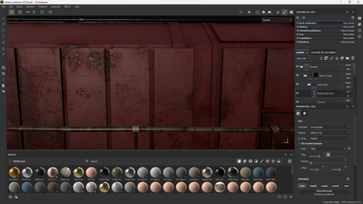

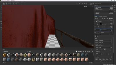

I've recently been working on texturing my model, however I noticed that my textures are low quality. Is there anyway to fix this? The resolution is 2048x2048, the preset is Unreal Engine 4 and the texel density is around 85%. Below are the pictures of the texture. The reason that I want these textures to look better, but don't mind the wheels and parts around that is the reason that the "platform" and the cabin will be accessable which will mean that players will be able to look closely at the textures

There is nothing wrong with your model as such, or the unwrap.  But, if you look at the last two screenshots in your first post, the area taken up by the closest panels (i.e. half the 3D viewport) takes up around 10% width and 10% height of your UV texture in the model you attached. So at 2048 x 2048 px resolution, when viewed that close,  half the viewport is taken up by just 200 x 200 texels.
You can check this for yourself by adding a temp layer and drawing a bright coloured line around the
You can check this for yourself by adding a temp layer and drawing a bright coloured line around the problem area in the 3D viewport. Now look at the UV and see what area that is using.
If you really need to view that close, what you might want to do is use a UDIM workflow and separate out those areas that will be viewed closely onto their own tiles where you can increase the resolution and add detail.

thank You for the help, I now understand. I'll try the UDIM method like You said.
