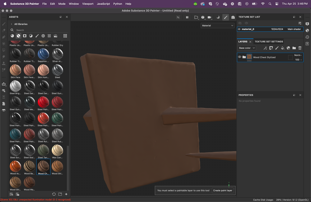

Hey everyone. I'm in a class where we're 3D scanning sculptures we've made and taking them into Adobe Substance Painter to texture them before bringing them into AR. My problem is when I try to apply textures to my model, they appear as one solid color with no detail, or a bunch of very tiny dots. I've tried baking textures, adjusting tiling size, and other texture settings, but nothing seems to help. Textures seem to apply just fine to demo models in substance, or other files generated from 3D modeling software. I'm not sure if there is an issue with my model from the 3D scanning process, but I just can't seem to figure out how to get textures to render properly on it. Heres a photo of it trying to render a wood bark texture:Screenshot 2024-04-25 at 3.46.31 PM.png

Hi,have you unwraped the model?
You can either unwrap the model inn a modelling software or there is an autounwrap option in Substance Painter too.

Thanks so much! I started messing with the unwrap options in painter and I changed the "Unwrap sequence"  to "recompute all" and that did the trick! Thanks again!
