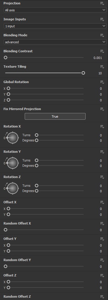

And the triplaner settings are as follows:
