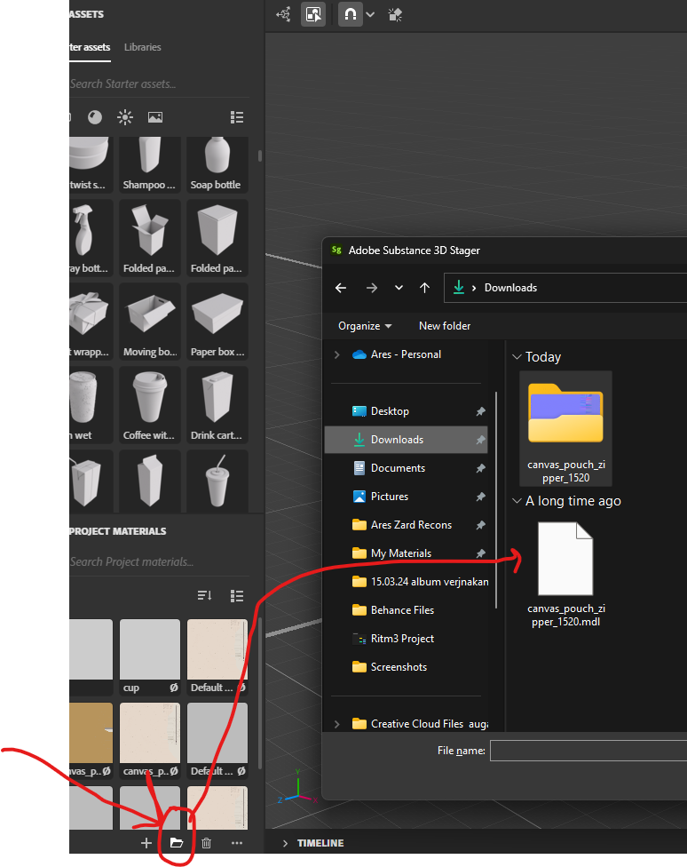

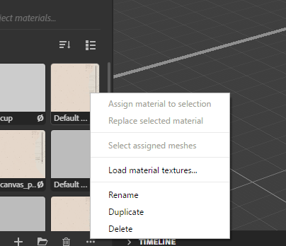

Not sure but maybe this can help you: Importing MDl into Stager, After importing you will be able to find it materials panels.

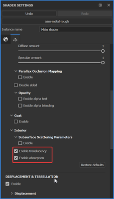

If you want to display the Channels properly in your 3D viewport, go to your Shader settings, and enable Transluency and Absorption.
