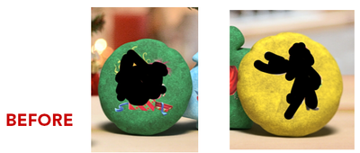

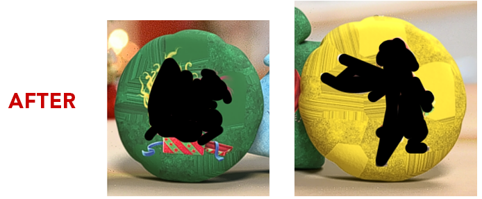

I have the same issue! I created this file a couple weeks ago, here's a before (opened/rendered with Stager 2.0.2), and after (done with Stager 2.1)...
Other than the very obvious issues with decals on materials, also colours, lights and shadows now render differently, on all files I'm opening.
I'm downgrading back to Stager 2.0.2 for the time being, but please @Cyril Dellenbach be aware this is an issue that needs to be fixed. People need to be able to keep consistency within their saved files.

I did some renderings in Adobe Stager a few weeks ago; the rendered items had a felt fabric type material applied to them, and an image decal on top of the fabric. (Image is blurred due to licensing copyright)
Both the material and the decal had satisfying quality.
I re-opened the same files today, to quickly edit and redo some renders, using the latest version of Stager. This is how the same items look like now :
This is not acceptable, I need to be able to keep consistency within the same files. I have tried to fix the texture and decal in every way, but they still show like in the 2nd picture, as soon as I apply the decal image.
The file had no issues whatsoever last time it was saved and closed, I need to be able to open files and find them exactly how I left them.
Has anyone experienced the same issue, and/or a way to solve it?
Thanks in advance!
Cyril Dellenbach
Jul 4, 2023 3:21 PM UTC
Hi @SilviaGJ,
This is indeed a very problematic regression.
As you already saw on this thread (which I'm merging this discussion to), we are aware of this issue and are currently working on it.
