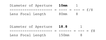

I am a bit late to the party but perhaps this will help.
One of the first things you will notice when you see the f/stop notations on the lens barrel is that, as the aperture decreases in size, the number assigned to it becomes larger.
It seems to defy logic until you are reminded that the instance when a larger number designates a smaller measure is when it is the denominator of a fraction. Note as we go from ½ to ¼ to 1/8, the denominator grows as the size diminishes. The fraction referred to here refers to the aperture in relation to the lens focal length. An aperture of f/8 has a diameter one-eighth the lens focal length. (Not exactly, and I will get to that in a moment.)
The beauty of this is that as the focal length increases (meaning the lens is further from the chip or film and the light diminishes within the camera), the aperture gets physically larger but, the amount of light gathered on the chip remains the same.
If this system of fraction-of-focal-length was not used as a reference, you would need a separate meter for each focal length of lens you used.
The lens is marked in increments that allow one half the light of its neighbor’s setting (or twice its neighbor) without you having to do the math to adjust the aperture. If you would like to calculate the system of halving the aperture and you have an iPhone, try this:
Choose the Calculator and turn the iPhone horizontally.
Enter: 1 x 2 then strike the square root key that is marked below, then hit the = key
Each click of the = key will step off the calculation for you as shown here,
Note that f/5.6 is really 5.7, f/22 is really 23. I never found any logic for this inconsistency but I'm too old to argue.
Now, don’t whip out a ruler and check the diameter of the aperture. It will be smaller than you might think. The reason is that the shutter on your camera is positioned between lens elements so that some of the light bending occurs before it reaches the shutter. The aperture is actually an effective aperture.
In addition, you cannot arrive at the precise lens focal length by measuring the distance from the lens to the chip when the camera is set at infinity. The distance must be measured from the emergent nodal point of the lens – the point within the lens where the light stops coming in and begins exiting the lens.  So, trust the accuracy of the specs offered by the manufacturer.
There us much more to learn about lenses. As I suggested earlier, hit the books.
