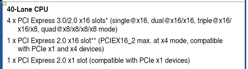

Here seems to be the relevant part of the manual. To me it seems pcie3_3 and pcie3_5 are the options. _3 shares bandwith with the onboard m.2 port which I'll be using and the u.2 ports which I wont be. pcie_5 shares with another u.2 port I won't be using. So, those two slots, is there any preference which to each one going where? I think maybe slot 5 for the hyper m.2 card, since that will be in use constantly, then the TB card in _3?

I am confused by this data from the instruction sheet.  It shows that even with the M.2 enabled that you should be getting x16, x8, and x8 on the first three slots.  That is more than the required x4 for the Thunderbolt and the Hyper M.2 card require so I do not see why you could not just use slots 1, 3, and 4.  (Slot 2 is just an x1 slot that is generally hidden by the double width GPU) Maybe Ronin or someone else can straighten me out.RoninEdits
I finally found out why slot 3 is no good it is a PCIe 2.0 slot only, not suitable for Thunderbolt or Hyper M.2 caqrd  Below they are showing Slots 1, 3, 4 I think?  So you indeed would have to try
Actually only Slot1 and Slot 5 (PCIex16_4) are not shared by anything.  I am sure glad I got the workstation x99 as it does not have all these if's, and's an but's.
*1:PCIe x16_3 shares bandwidth with M.2 and U.2_2. It runs at x16 mode by default. PCIe X16_5 shares bandwidth with U.2_1. It runs at x4 mode by default with U.2_1 enabled.
*3: PCIe x16_2 shares bandwidth with USB3_34 and USB 3.1_EA34. It runs at x2 mode by default.
Sorry but I give up!
Valorous Hero ,
Apr 06, 2017 Apr 06, 2017
MyerPj, i don't think there is any difference for which card is in which slot. both cards use 4 lanes, and both slots with your setup can run at x8. setting up the thunderbolt card can sometimes be tricky, but i'm not aware of slot x16_3 vs x16_5 making a difference for that.
to bill, you are close, option 3 in that picture is correct. what you seem to be missing is slot x16_4 appears to share lanes with slot x16_1. that's why its best to avoid when possible, to keep the gtx 1070 in slot 1 at x16 and not drop to x8. the WS motherboard can be just as tricky, if not more so, to figure out the best placement for multiple cards as there are even more lane splits to even more slots to figure out.

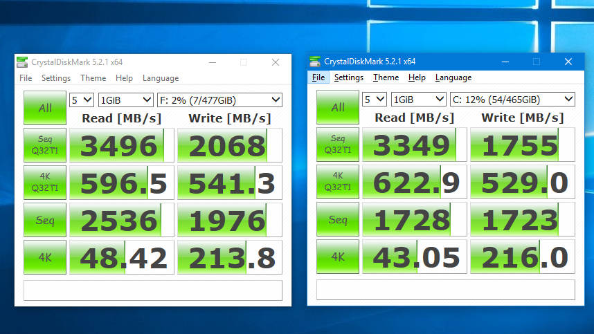

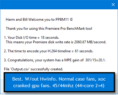

I've been up and running of course, but still tweaking it here and there. Was able to run PPBM many times, I got good at it. Even had a shortcut to Project Settings/General. This was my best run. Left the system just a tick down on this at 44ghz on all cores at 1.225v, VERY QUIET! I hadn't realized before that the Windows Power settings manipulated the CPU clock speeds. I wanted to keep my processor and GPU clocking down at idle and managed that well. I got 18's on the Disk I/O several times otherwise it was 19. This was C: (960evo) OS/Programs/Default Cache and previews, F: Project, Files and Export (960pro).  Only the h.264 times seemed a bit off. Tried running it in different ways, but kept getting around 60-63. BTW: Saw some drop off in speed having SnagIt open.

Great Info
  1. Your Disk I/O test 18-19 seconds is excellent I have run two 960's in RAID 0 with no improvement.
  2. Jumping ahead the CPU intensive export is that 301 seconds and with your I7-6850k 6-core CPU at 4.4GHz (I am guessing that is what you are running at) is a new high for a 6-core system so I am updating my PPBM8 CPU chart​ with your new data.
  3. The companion score to that CPU test is the GPU Accelerated 15 seconds so here your GTX 1070 is doing a great job and equals the score that I got with a GTX 1080.  Did you raise the Memory Clock on that 1070?
  4. Now for the H.264 Timeline export.  You have a very good 61 seconds because in addition to the GPU Acceleration this timeline is also CPU intensive so starting with CPU score of 301 seconds your great 61 seconds being slightly higher than my results until you look a my Core, Threads and Clock on the bottom of the page results with 6-cores you are doing excellent.

Thanks Bill, I really appreciate the feedback. I had the core clock at 44/45. Two of my cores 2 + 4 run about 3-5* hotter than the others with full load. So, I was trying some overclocking at the time to balance out the temps and thus ran the other cores faster. I was pulling in 301-305 on the disk i/o tests. I left it at 4.4ghz in the end so I could use the Asus recommended  "sync all cores". On the 1070, I did have the memory clock raised just a bit. I did some overclocking on the clock speed and I was able to get +75->100 to run with the Heaven benchmark. In the end, the 1070 FTW2 is already clocked quickly and seems plenty fast, so I've left the 1070 at default settings for day to day work, but run XOC at startup to spin up the fans from their default 'off' (bummer you need to have the software running to speed up the fans. (unlike the computer BIOS (uefi)). Here's a screen shot of Crystal having run the two 960 (F: PRO, c: EVO) at the same time.
