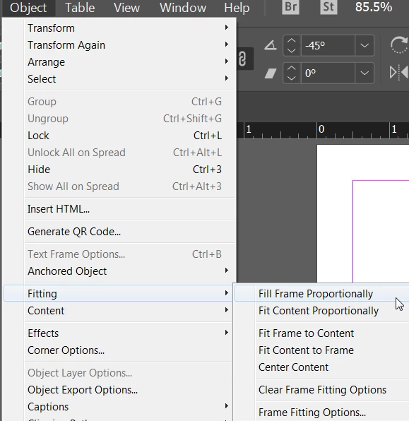

    Use Object > Fitting Options to position the picture within the frame.

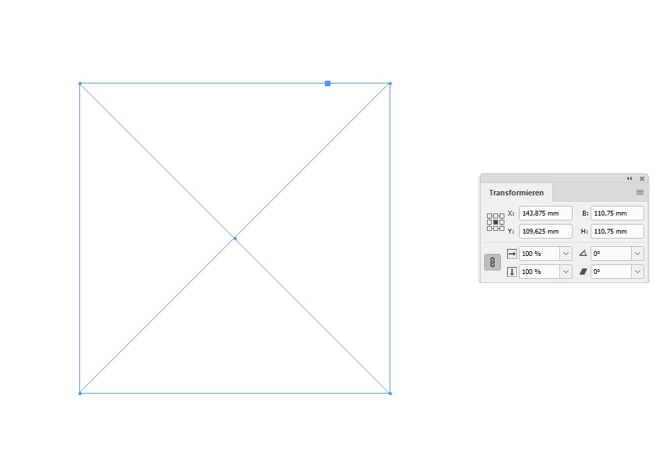

    Aug 6, 2018 4:02 PM UTC
    One addition to what Barbara said:
    If you select the rectangle (square) with the Direct Selection Tool ( that's the "White Arrow Tool" ) and then rotate by 45° or -45° the placed image will not be rotated as well.

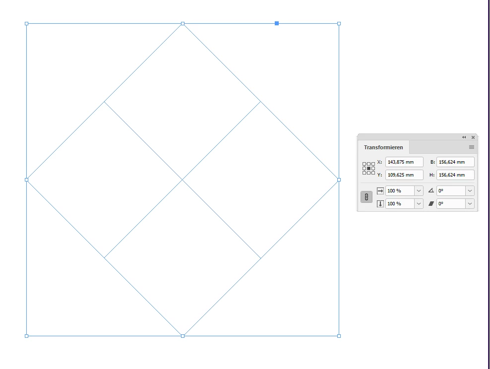

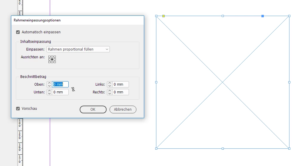

    Preparing the frame with fitting options. Fill frame proportionally:
    Select the frame with the Direct Selection Tool. See how the 8 handle widgets are changing to 4. Now the 4 path points of the square are selected:

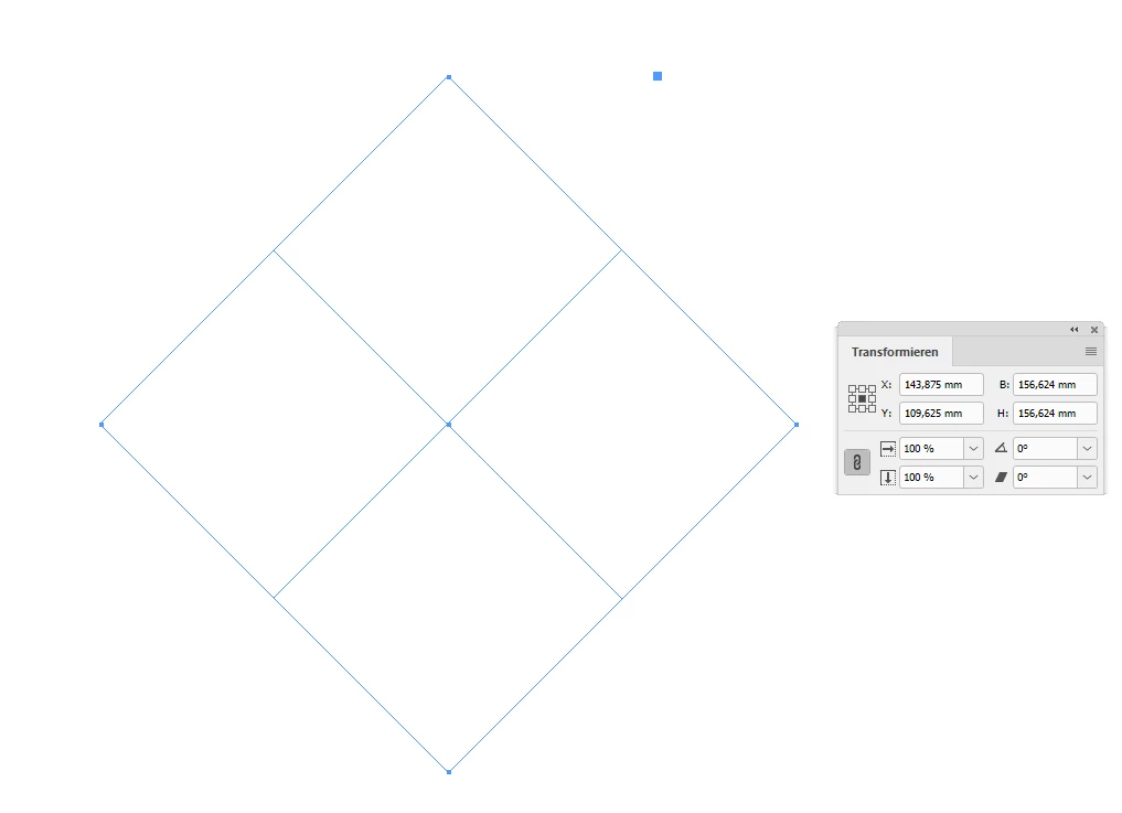

    Now rotate to 45° or -45°  ( it will make no difference ):

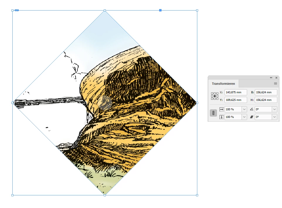

    Frame selected with the Selection Tool:

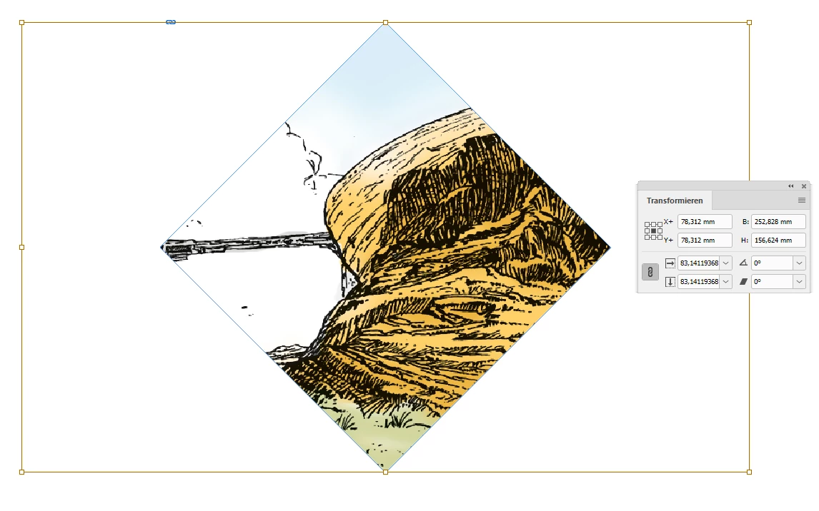

    Image placed to the selected frame:
    Image selected:
    Uwe
