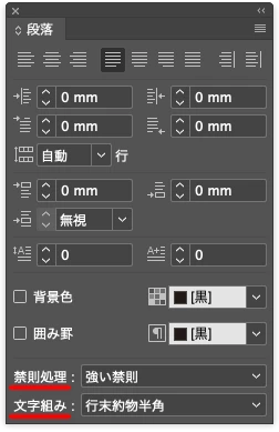

Hello, thomas_1459
If you can use the Japanese edition of InDesign, then selecting the top item from the pull-down menu at the bottom of the Paragraph panel thar named (“段落”), respectively, will solve the problem.
If not, can this script solve the problem?
var allParagraphs = app.activeDocument.stories.everyItem().paragraphs.everyItem();
allParagraphs.kinsokuSet = KinsokuSet.NOTHING;
allParagraphs.mojikumi = NothingEnum.NOTHING;
This will work for all paragraphs in all stories on the document.
It does not work on tables or anchor object text frames.
Also, I should be editing paragraph styles rather than paragraphs, but well, it's a test anyway.
Add code if you need it.
Best.
Abhishek Rao
