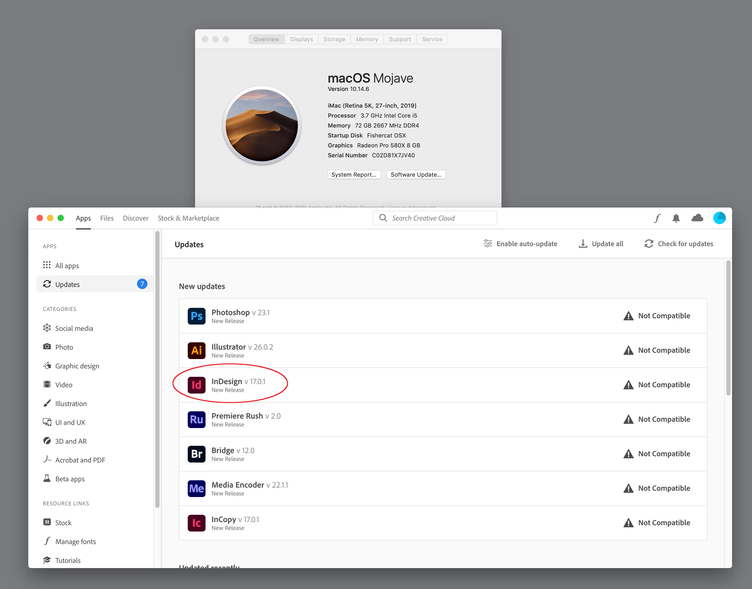

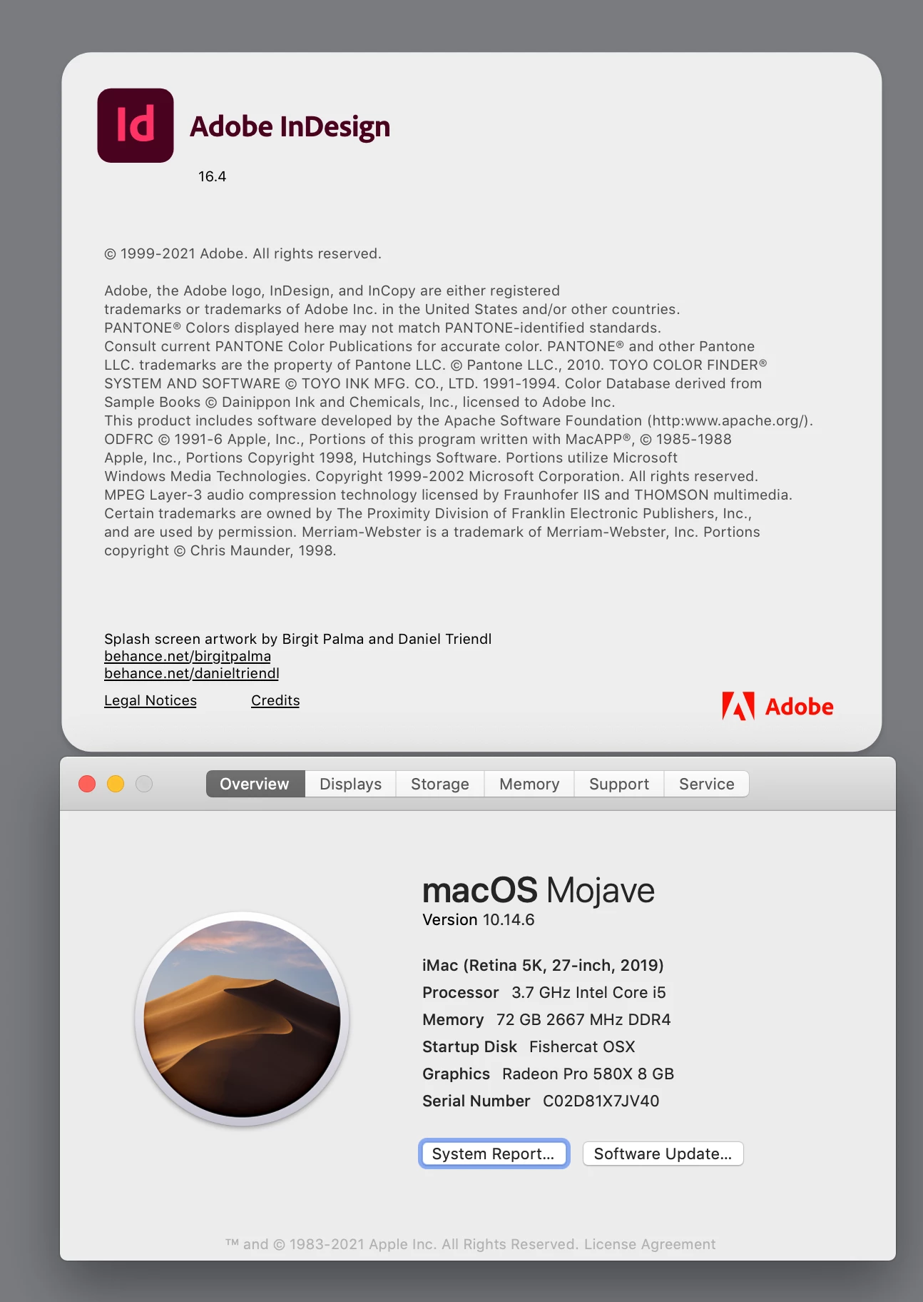

Just to clarify CC2021 will run on Mojave—it’s the latest version CC2022 (17.01) that needs Catalina or later. I’m currently running CC2021 16.4 with Mojave.
