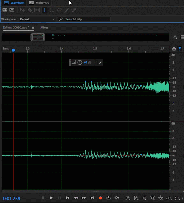

In this video, you will understand how to use different tools in Adobe Audition to remove various types of noises like wind noise, ambient noise, statics, and mouth clicks.

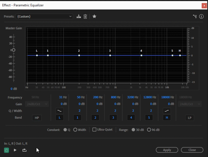

0:40 - Parametric equalizer high pass filter for wind noise reduction

3:54 - How to remove mouth clicks
4:39 - Enhancing mouth clicks with compression

High Pass filter
Generally, wind rumble consists of lower frequencies. High Pass filter can be used to remove it as it allows the higher frequencies to pass through and removes the lower frequencies. While using this filter you need to specify the cutoff point at which the frequencies are removed.
You may also adjust the Gain to control the slope or the intensity at which lower frequencies are filtered out.
Effects > Filter and EQ > Parametric Equalizer
High Pass filter can be applied using Parametric Equalizer

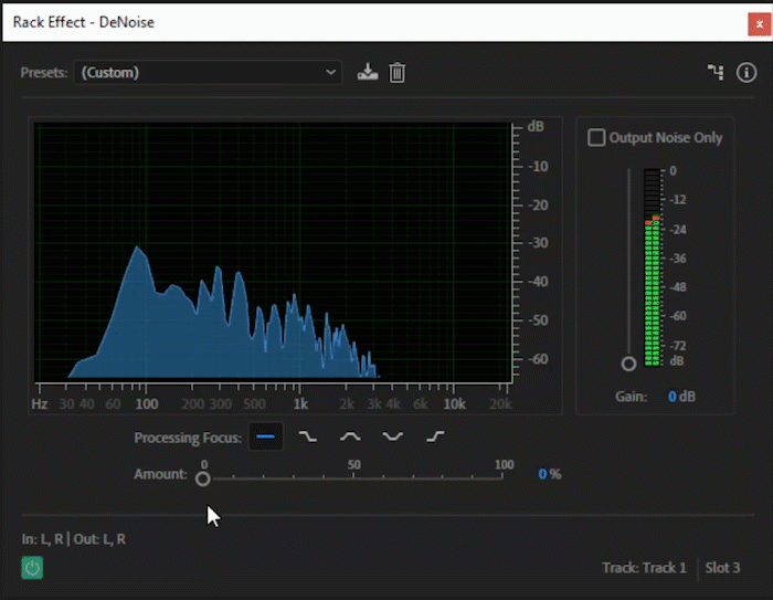

DeNoise effect
Background or surrounding noises can be reduced or removed by using the DeNoise Effect.
This effect provides a simple slider that controls the amount of noise reduction ranging from 0% to 100%. Using DeNoise effect can reduce the volume level which can be compensated by increasing the levels using the Gain slider.
Effects > Noise Reduction/Restoration > DeNoise
Learn more about DeNoise effect

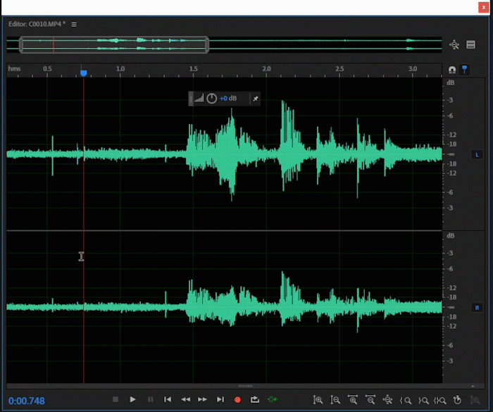

Noise reduction using a Noise Print
This Noise Reduction effect dramatically reduces background and broadband noise with a minimal reduction in signal quality. This effect can remove a combination of noise, including tape hiss, microphone background noise, and power-line hum.
This method is preferable for removing any noise that is constant throughout a waveform.
Here you extract a noise profile from a selected range, indicating only background noise. Adobe Audition gathers statistical information about the background noise and then removes it from the remainder of the waveform.
Effects > Noise Reduction/Restoration > Noise Reduction
Please note that this effect only works in the Waveform Editor and is unavailable in the Multitrack editor.
Learn more about Noise Reduction effect
