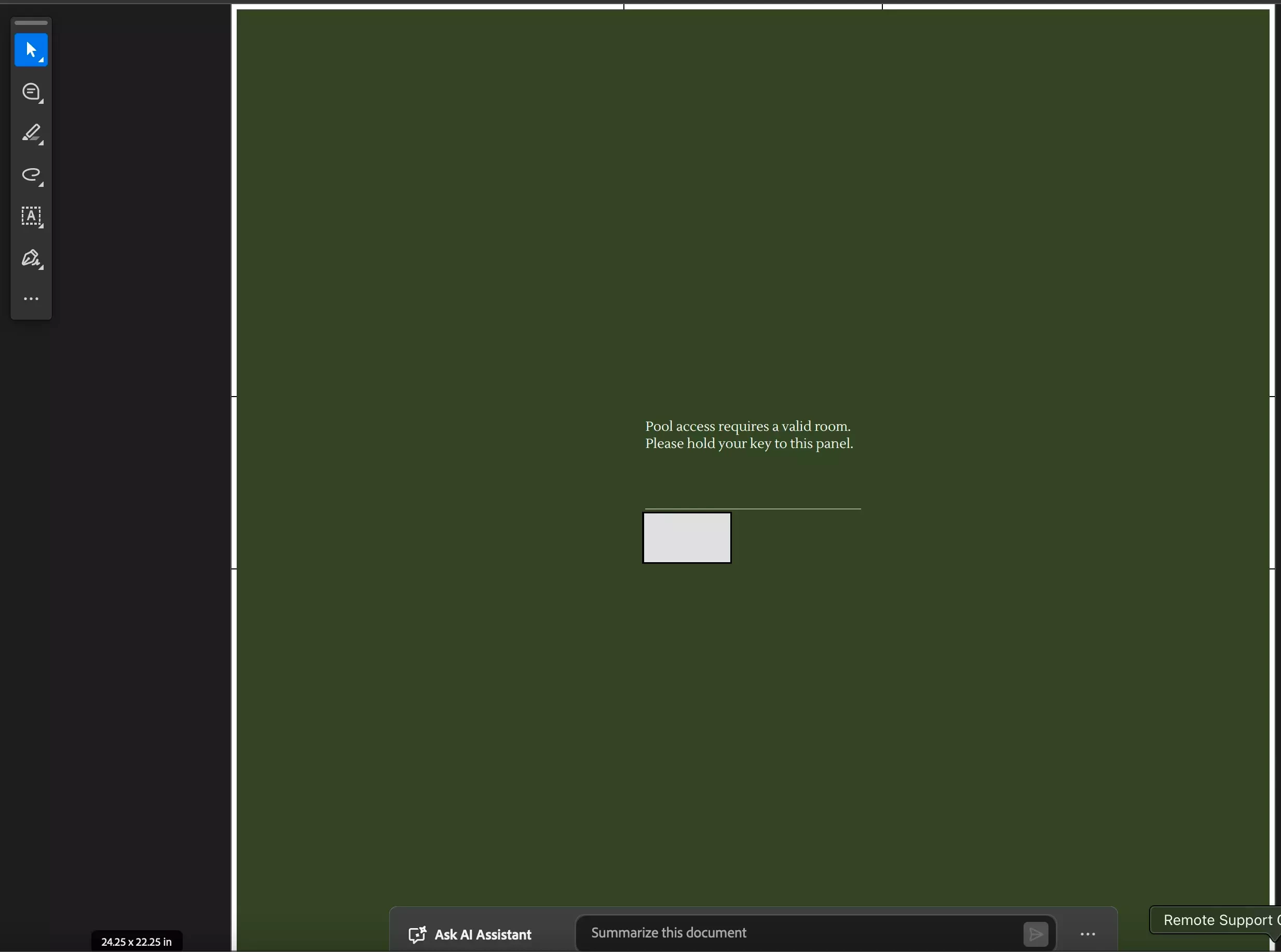

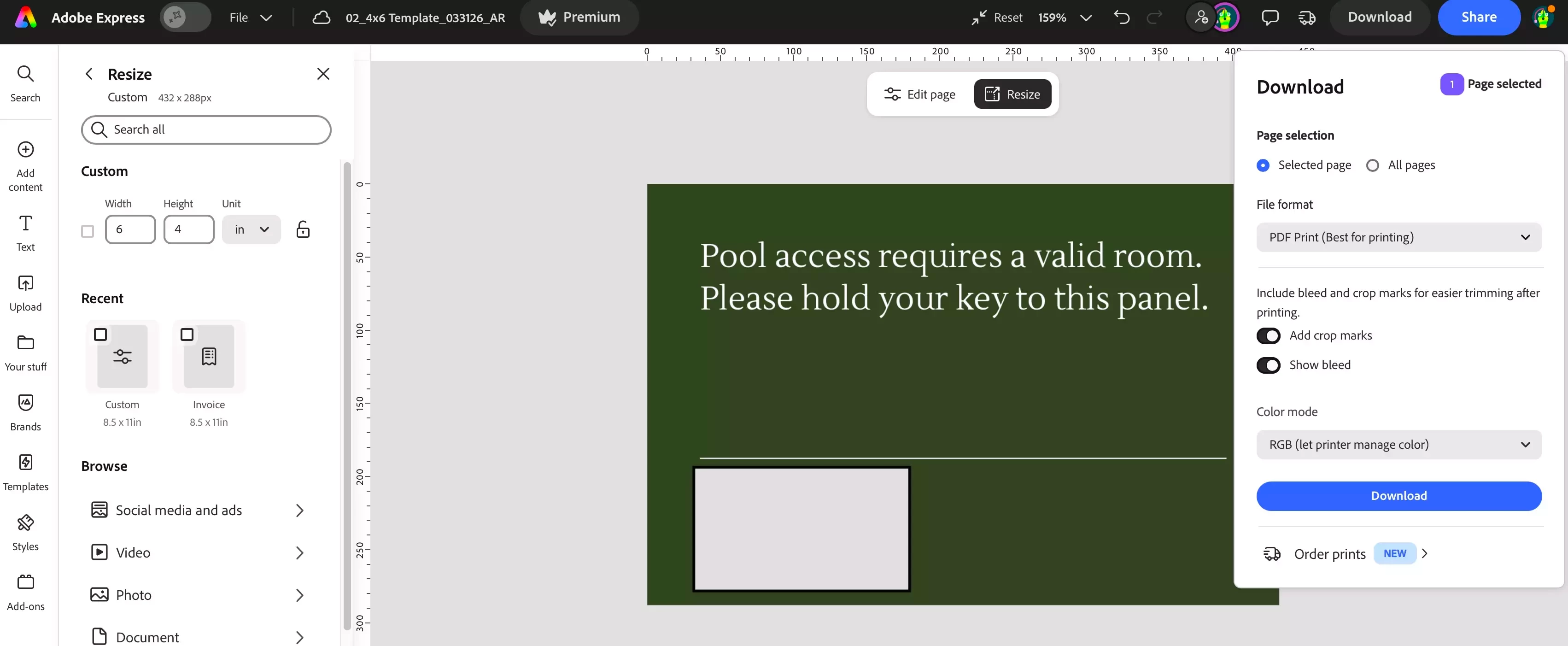

    I am trying to export a template out of express with crop marks and bleed. I have had no problems until recently, where the file is now exporting instead of 4x6 at 24x22. Attaching images to show canvas size and what size it is opening as in acrobat when I download it
    Rose DV
    May 26, 2026 6:04 PM UTC
    Hi ​@amelia_2020!
    Thank you for the screenshots - that's a really clear illustration of the issue. This is a known bug we're actively working on.
    Could you try a workaround that's helped some users in the meantime? Go to Edit Page/File > Resize and switch your canvas units to inches, then re-export as PDF Print with bleed and crop marks enabled.
    If that doesn't resolve it, could you also share the project link with edit access via DM (click Share > Who has access > Anyone > Can edit) - please make a duplicate copy of your file for yourself first!
    That way we can pass it along to the engineering team directly.
    Rose
