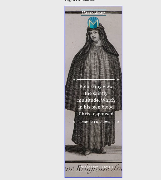

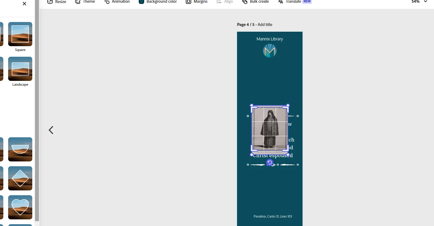

February 10, 2025
Hi All I am still having this issue. I crop the image and it appears cropped, I click anywhere and it looks cropped. However, when I attach the image as a background, its shown not to have worked. Example I croped this historic image to remove the text below to make a book mark, but when I attach as page background the text is still there and it doesn't appear as it should.
Amitej S
February 10, 2025
Hey @amy_3332, This workflow is as designed! When we use the image as an asset on the canvas, the crop overlays it. When the image is used as the canvas's background, the crop overlay is disabled, and the original image is set as the background!

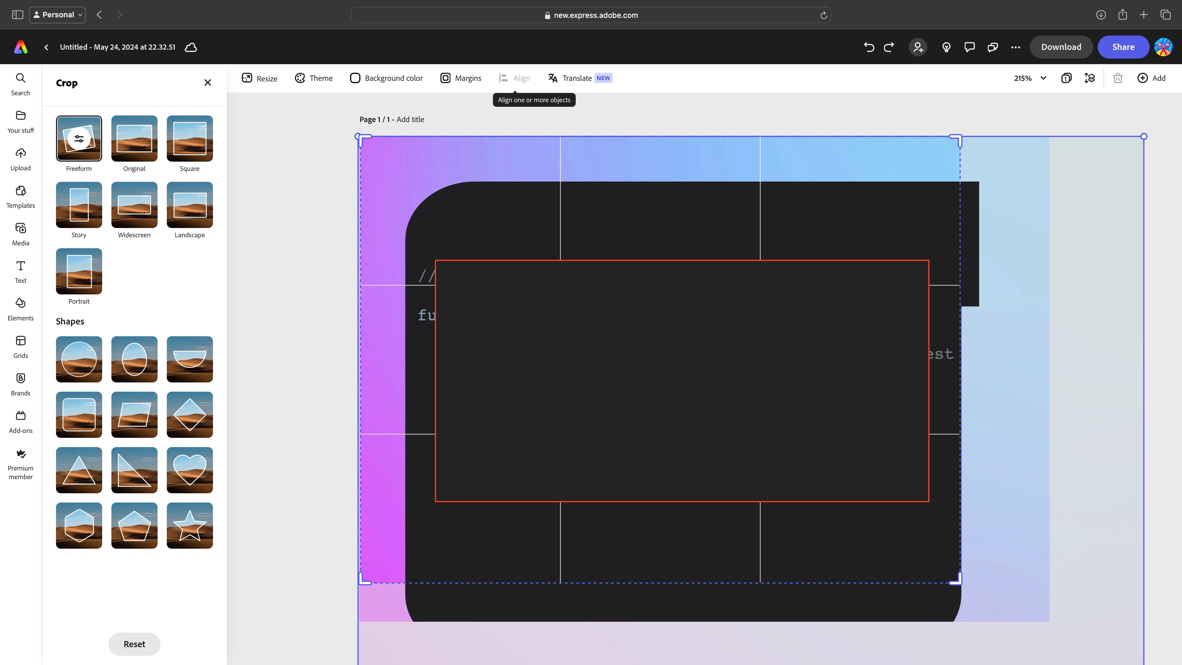

same here I can't crop tried clicking outside the image.  So frustrating.  Not sure what I am doing wrong but like other users I figured there would be an OK or CROP button somewhere?  Can't crop the shape I selected.  Screenshot attached. (I blocked out the text with an image for this upload)
Tarun Saini
May 27, 2024
Hi
@T369386125c13
As suggested by
@Abhi.G @ ADBE
above, "There is no Done/Apply, but clicking anywhere on the design canvas outside the image has the effect of committing the crop." Did you try that?
Tarun
