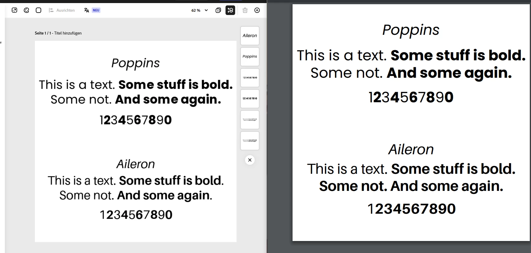

Probably I have to clarify my tutorial. You have to at least do "regular, bold, regular". The second regular results than in bold.
And you are right, some fonts do work like Poppins for example. I could not find any default fonts in the font selection but for example Aileron doesn't work:

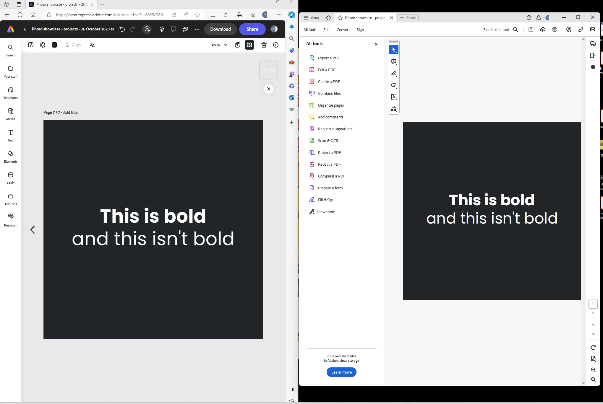

I had a go as well, and it works with the font I used, that why I thought it was more a font issue than anything else, although , of course, I could be wrong.
Font Poppins. It's synced from Adobe Fonts on my system (separately from Adobe Express)
Left is Adobe express in Edge, and right is the resulting PDF in Acrobat reader...
Not sure what the issue is to be honest.

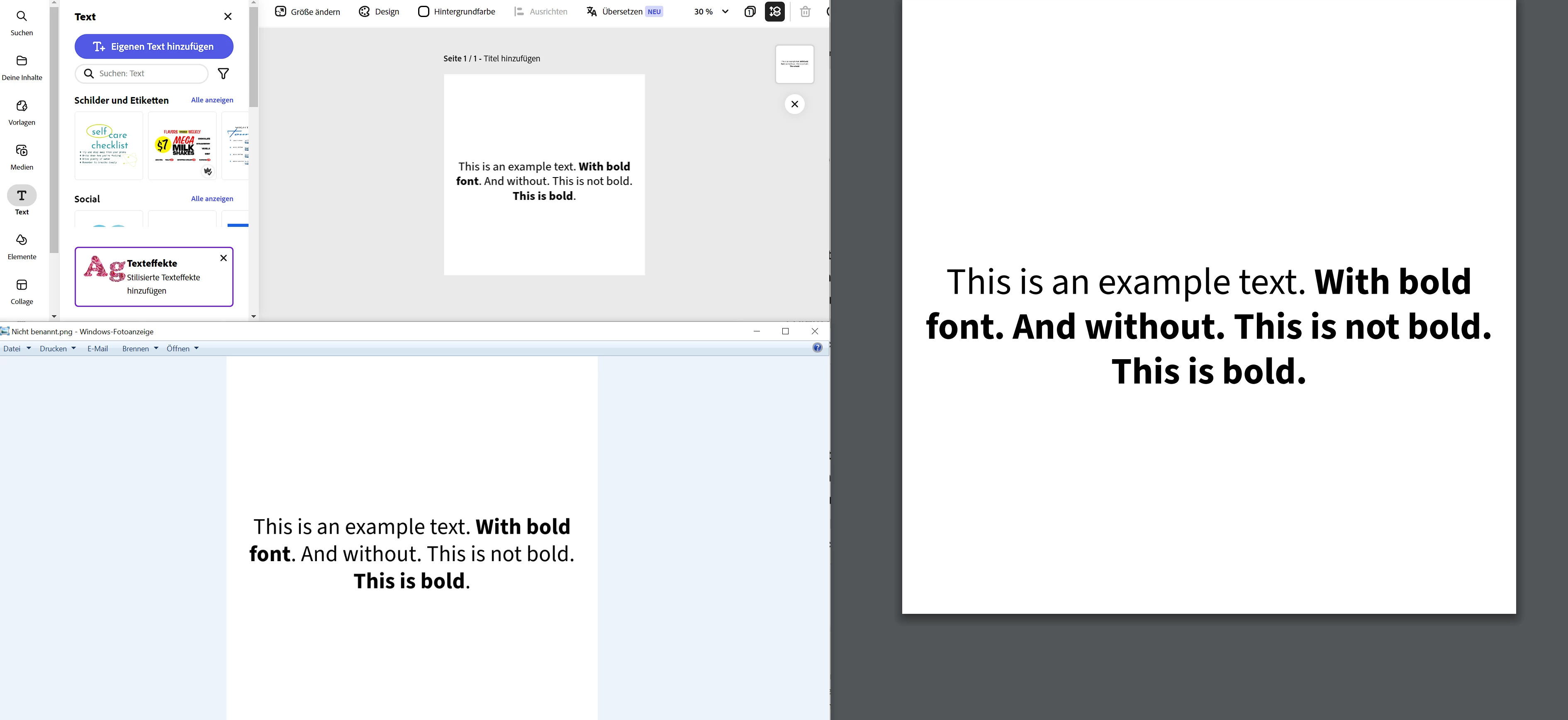

I was able to test the problem a bit more.
How to reproduce:
  1. Create a new document.
  2. Add a text.
  3. Add bold and not bold text into the text.
  4. Export as PDF
In the PDF (right side) you can see the font is not correctly bold. The PNG export is working.
My system is lastest chrome without any addons.
I contact adobe support about it. Looks like it's a issue with the PDF exporter in Adobe Express.
As a workaround you can use the to PDF converter: https://helpx.adobe.com/ca/express/using/edit-document.html
(However this is only a embedded image into a PDF)

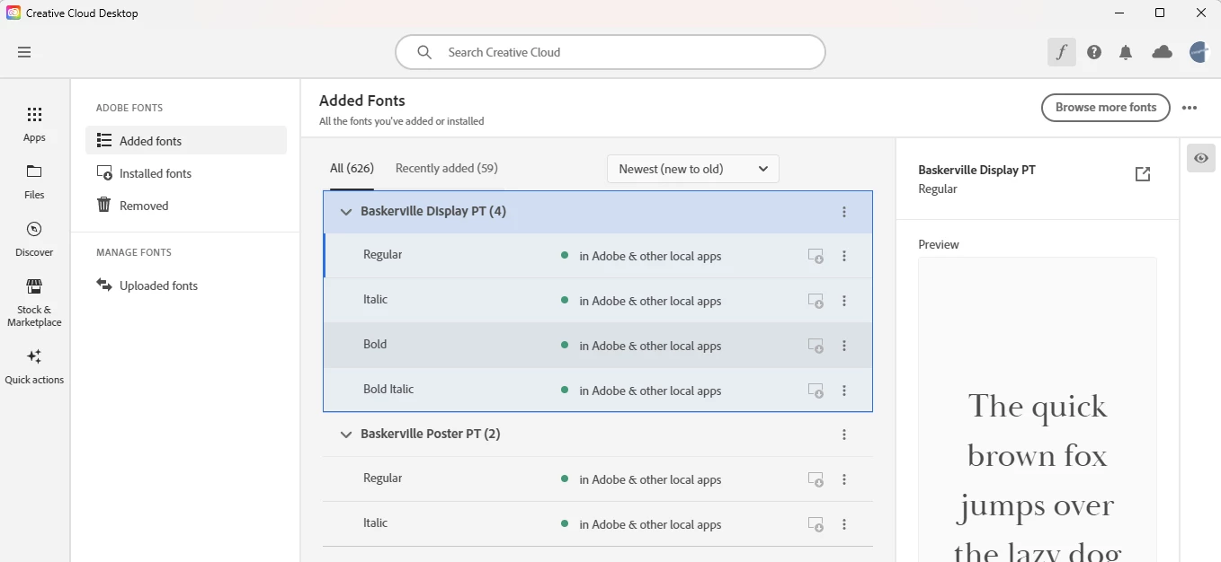

If you have a paid subscription for Adobe Express (or a full CC subscription) then that means you have access by default to all the fonts within the Adobe Fonts platform, and more likely the bold version of the font you're using.
You'll have to use the Adobe CC app to update the fonts you're using
