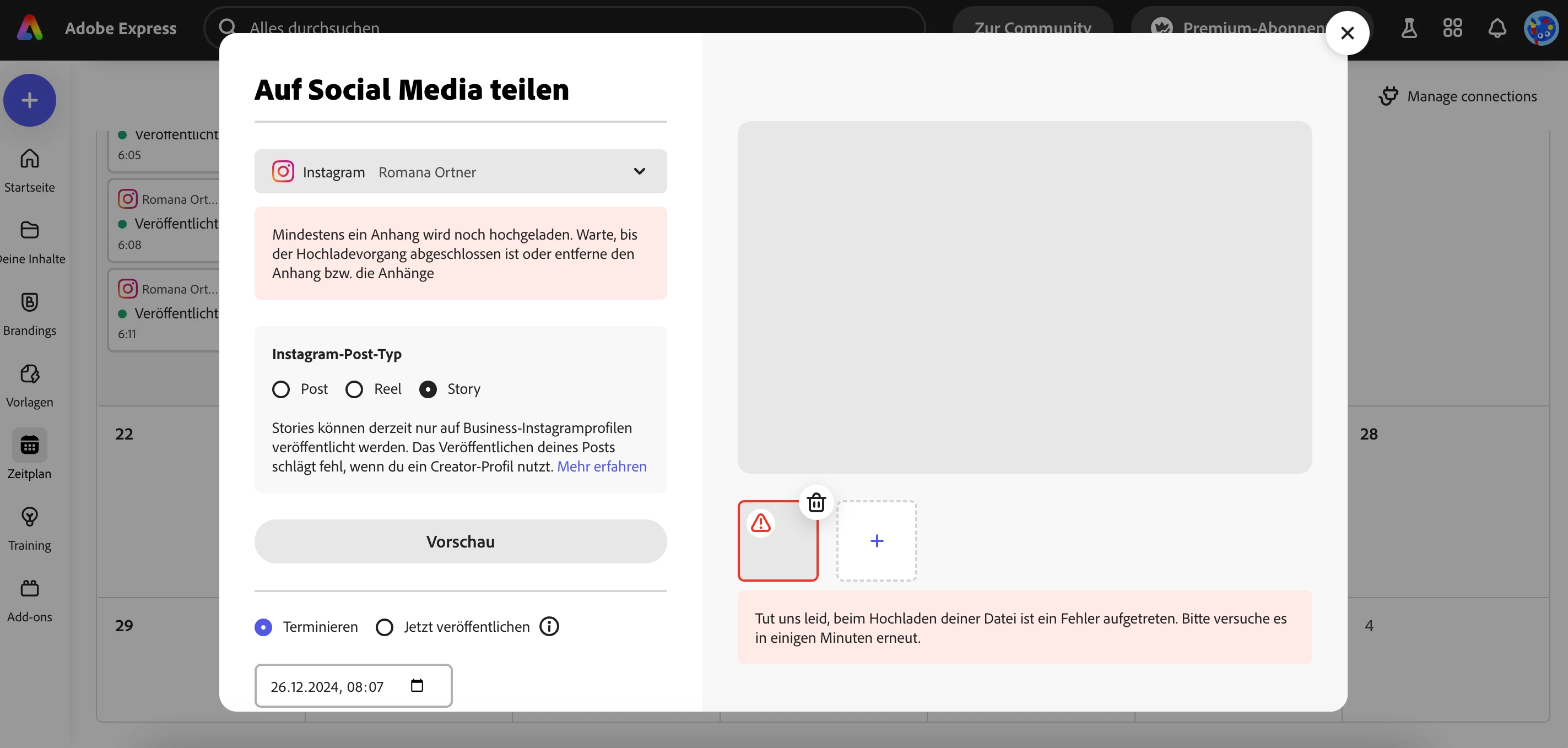

Dec 17, 2024 7:10 AM UTC
Hi @David__B
hier ist die Fehlermeldung.
David__B
Dec 16, 2024 11:28 PM UTC
Hi @romana_3537
Sorry to hear about your difficulties. Would it be possible to share a screenshot of the error you're receiving?
