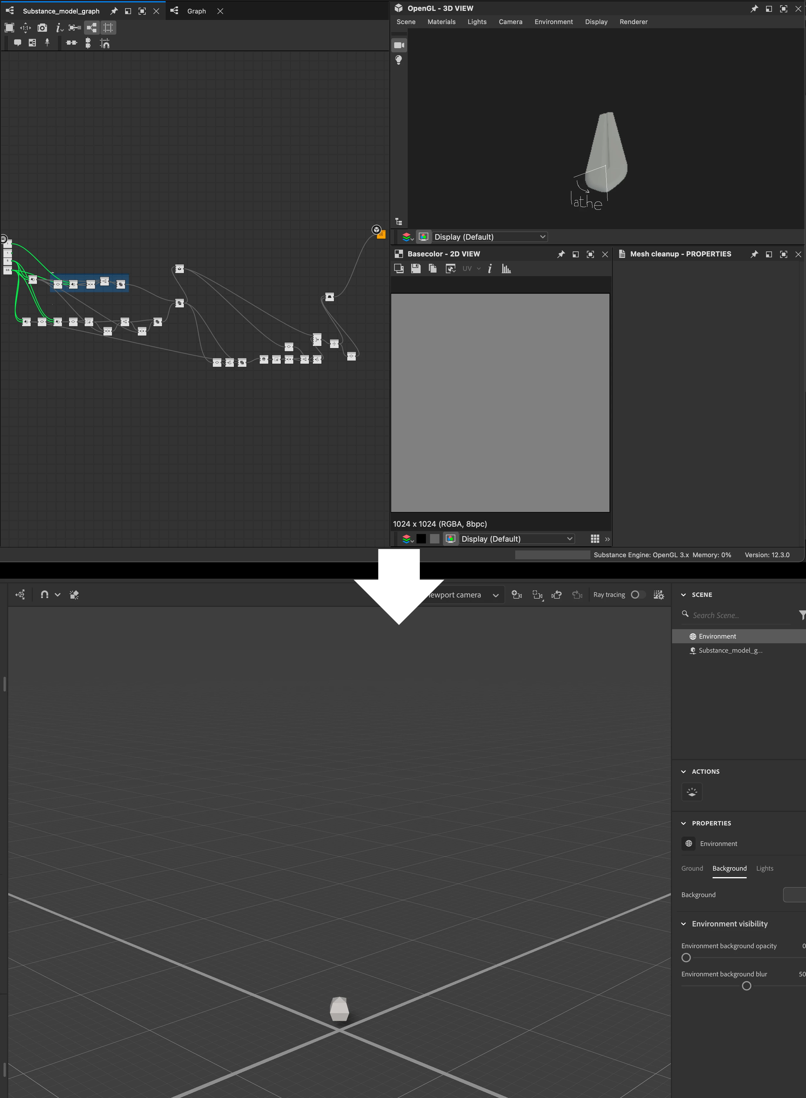

Hi! Since the latest update I can no longer send substance model graphs to Stager. If lathe is used anywwhere in the model, Stager just recieves/produces a lowpoly ball.

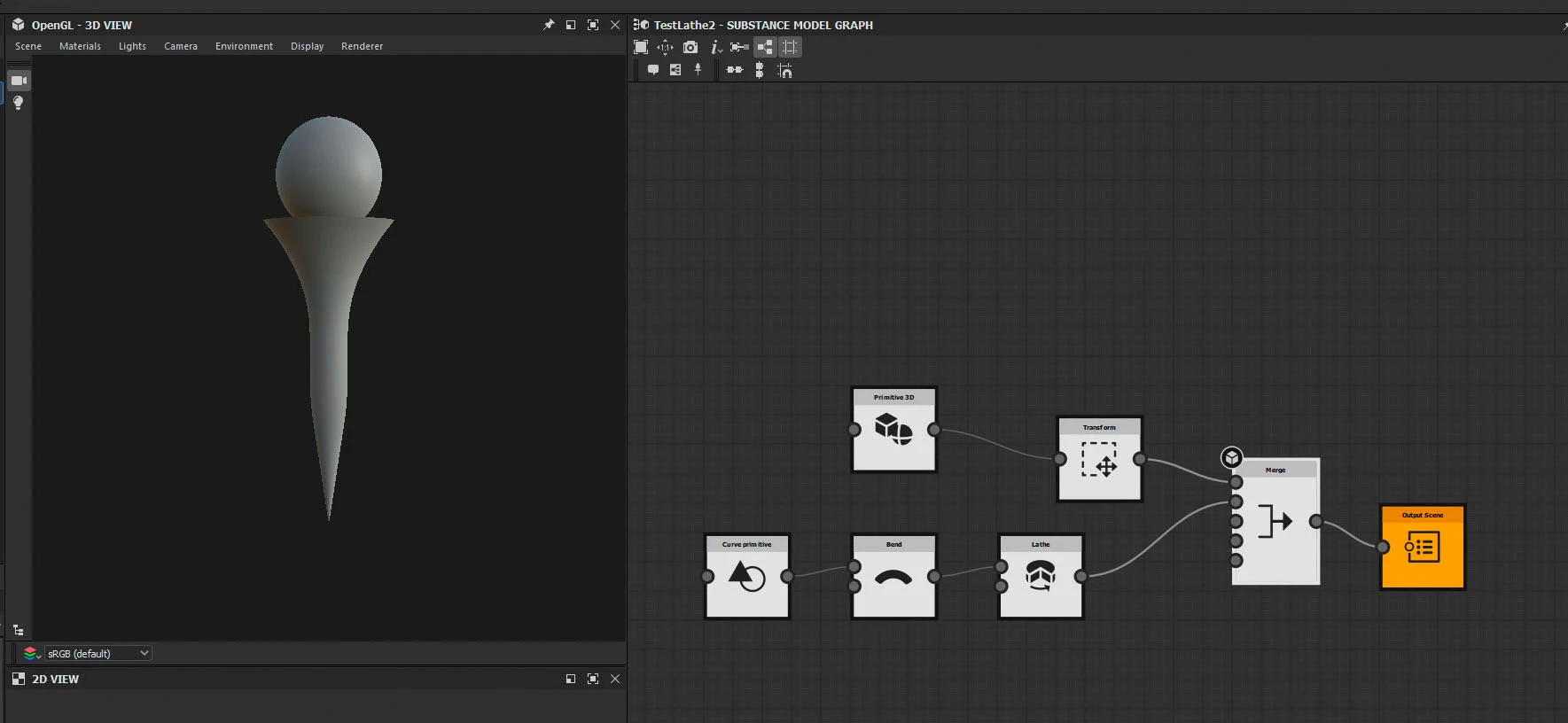

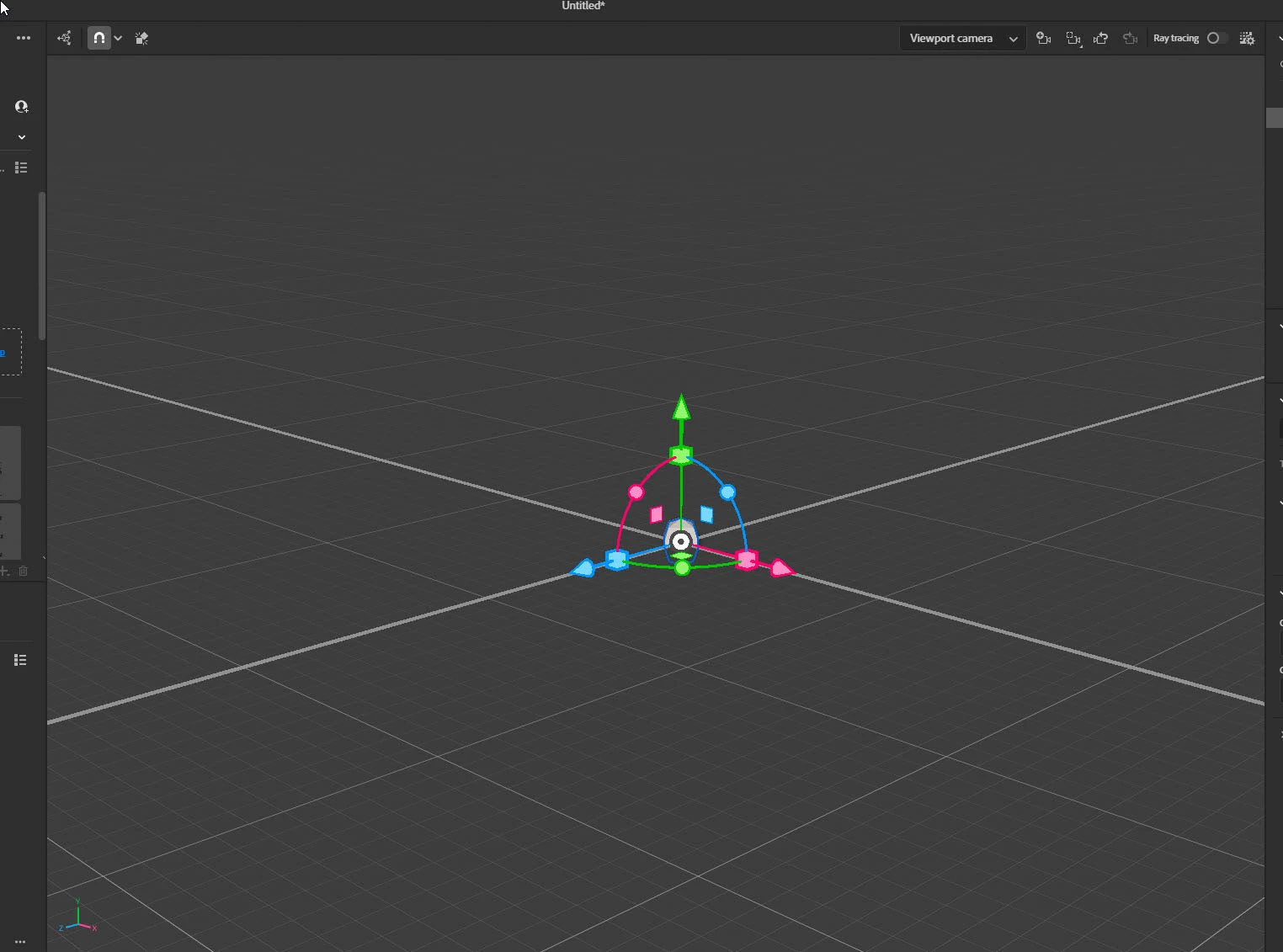

    Oct 24, 2022 12:00 PM UTC
    Yes - I can replicate that - introducing the bend node to the previous test model broke the model on Send to Stager.
    I'll tag Adobe's @Luca Giarrizzo to see if he can help, or flag this to the developers

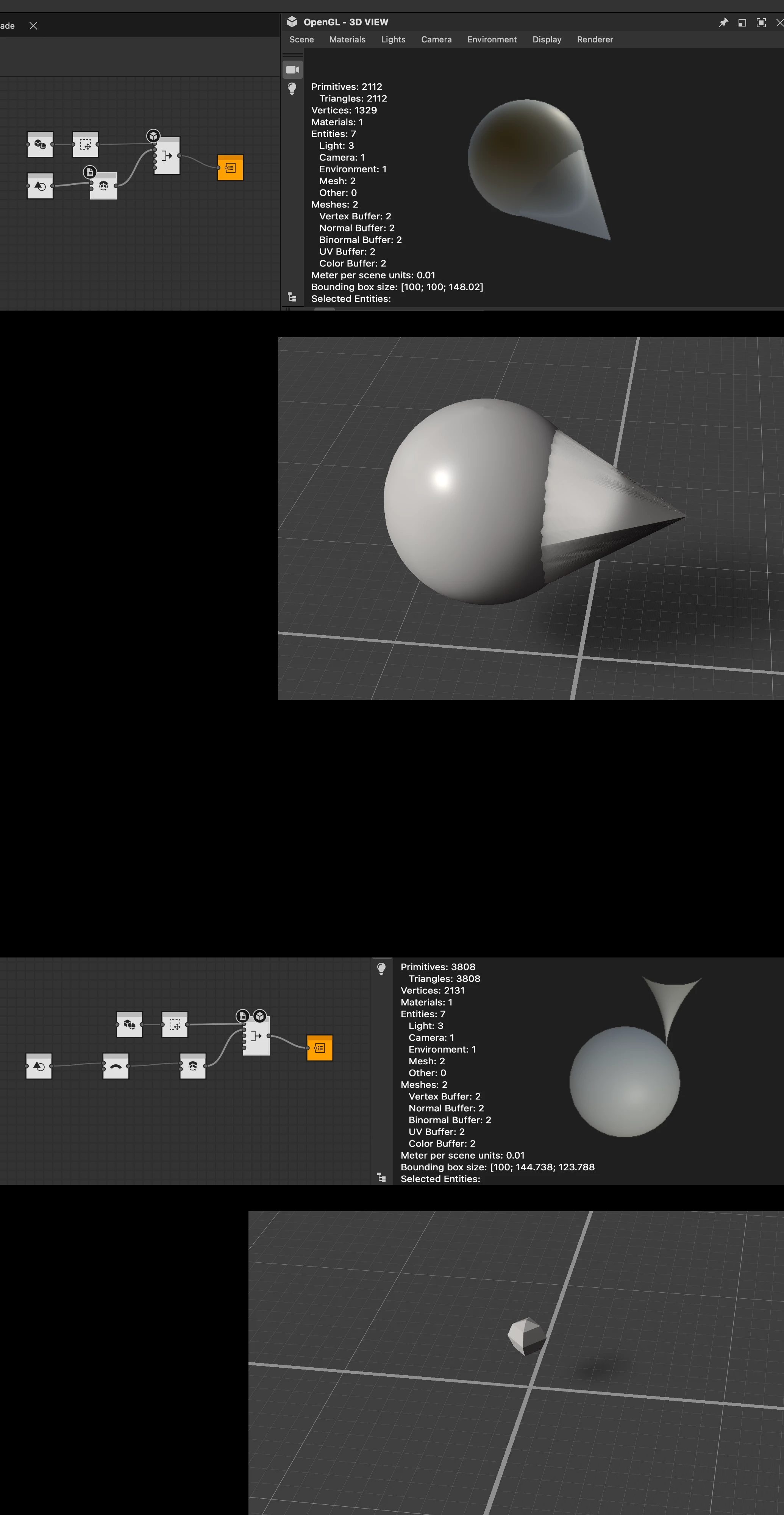

    Oct 24, 2022 11:44 AM UTC
    Many thanks Dave,
    I did a graph similar to yours and yes that works. The problem seems to occur when I use bend on a polyline and then use lathe on it. I am using a mac...

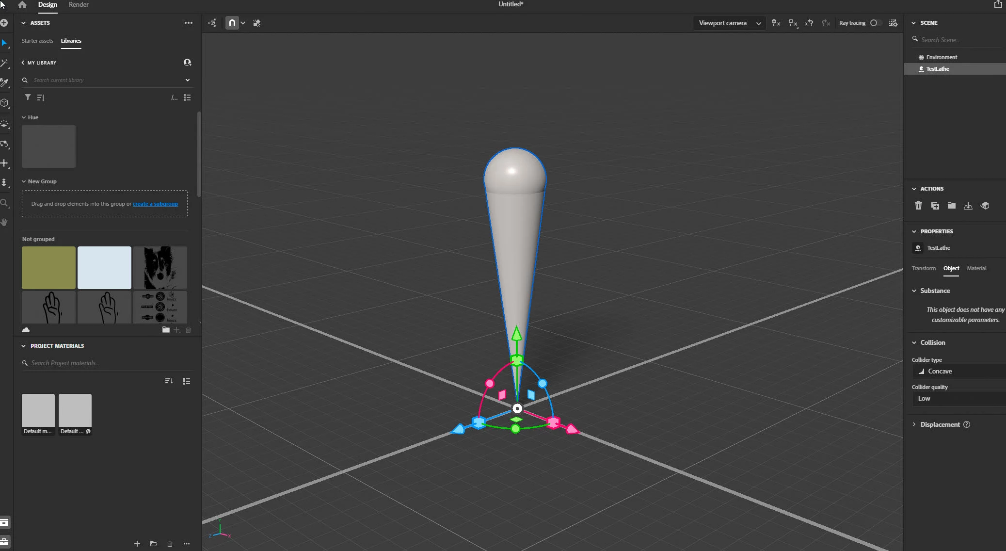

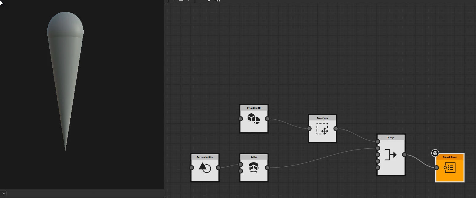

    Oct 24, 2022 10:49 AM UTC
    I just tested here with a very simple test graph using the Lathe node and it sent to Stager without issue
    Substance Designer v12.3.0  Stager version 1.3.0
    Windows 10 v21H2
    Dave
