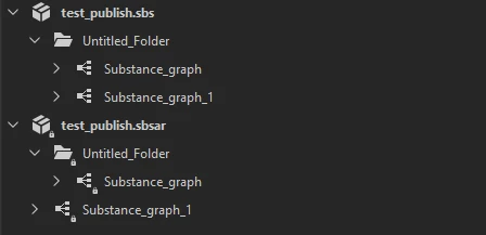

example image attached.
When publishing sbsar the internal folder structure is lost - it appears that only the first graph within a folder retains it's original path.
This behaviour occurs with  Designer 12.3.0 and Automation toolkit 12.4.0 on more than one machine
This is a significant issue when batch replacing dependencies

    Thankyou Cyril
    I did some further testing around this and when querying the cooked package contents via substance automation toolkit using SBSArchive.getSBSGraphPkgUrl() the relative paths stored inside the archive report as being correct.
    Despite this, sbsimpact manager cannot locate the correct path when calling declareSBSMoved()
    Some hint as to the underlying cause may help me to work around the problem as I imagine a patch will take some time to implement

    Hello Malcolm,
    Thank you for reporting, we were able to easily reproduce the issue. I've already made sure the rest of the team is aware of the problem and I'll get back to you as soon as it is solved.
    Thank you for your patience.
