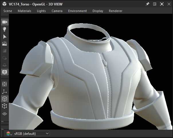

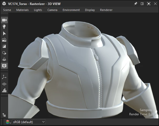

Rasterizer renderer does not render baked normal map correctly on symmetric models
When selecting the Rasterizer Renderer, baked normal maps does not render correctly on symmetric models. The OpenGL can render it correctly, but it was recently marked as deprecated and added a warning that it will be removed.

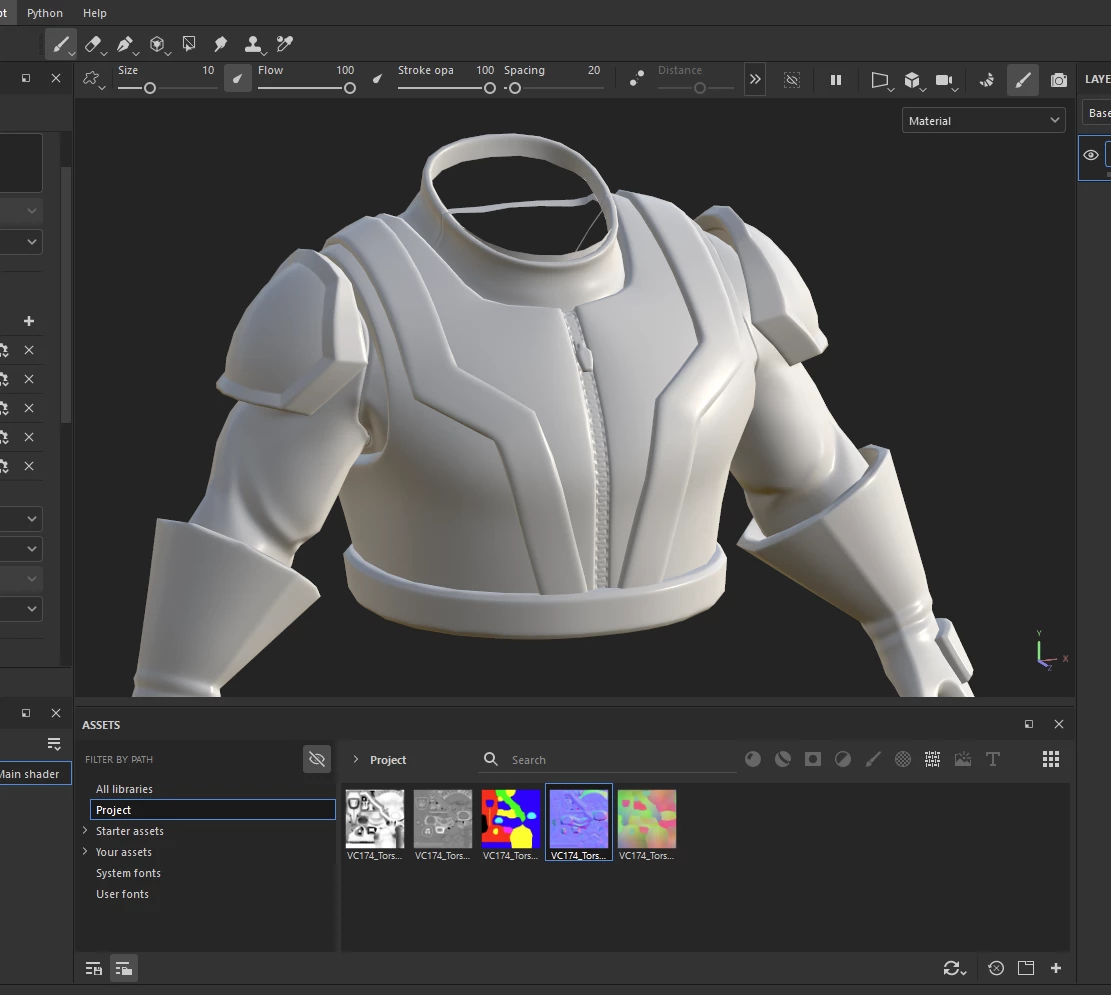

No issues with the normal map on any other app, including Painter
On Substance Painter the maps looks fine.

    Hello ​@default6kbf59ahqjpz, thank you for reporting this!
    We were able to reproduce the bug internally with a test asset. We shared the asset and details with the engineering team that works on the Rasterizer and GPU Pathtracer 3D renderers.
