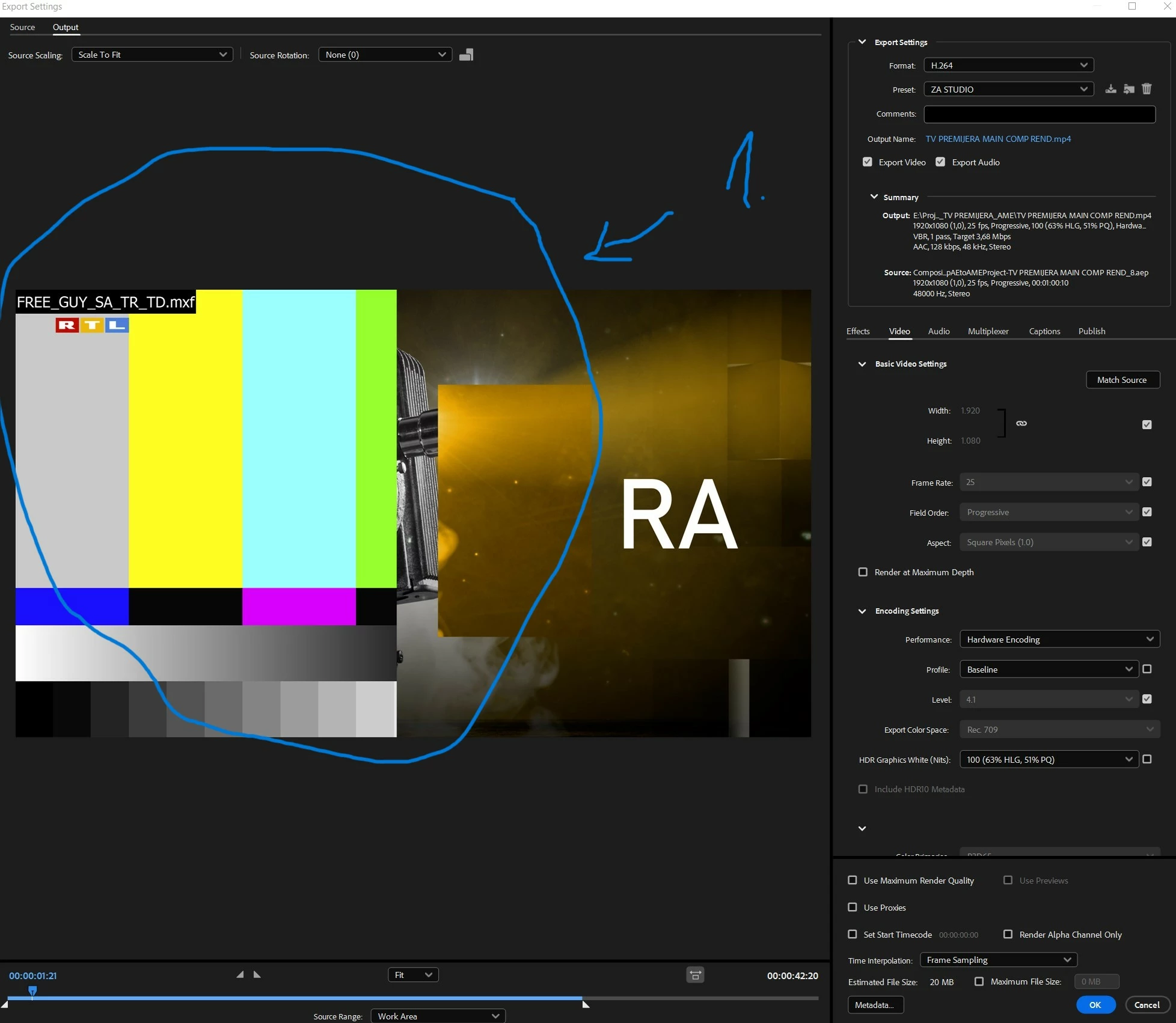

In short, Encoder does not see a single media/video when I export from After Effects
1 picture: 1. you can see that the channel with video is on (FREE GUY SA TR TD) 2. you can see that the channel with graphics is on (TV PREMIER). 3. it is clear on the screen that both are turned on.

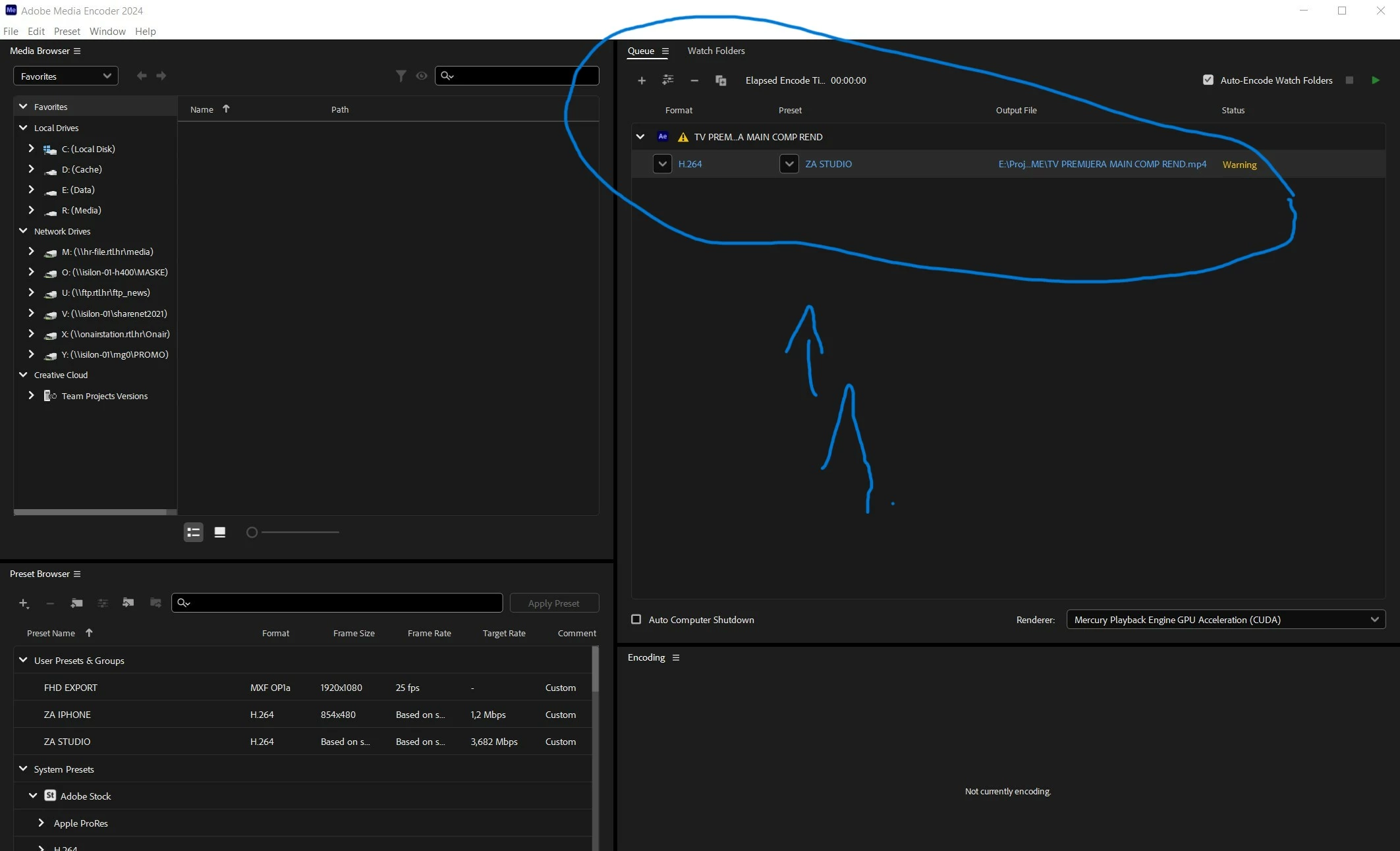

After that, I press File/Export/Media Encoder in After and Media Encoder opens
 2 pictures: 1. in Encoder you can see that there is no video (FREE GUY SA TR TD) while the graphic (TV PREMIERE) is visible, although you can see in the upper left corner that the video (FREE GUY SA TR TD) should be there.

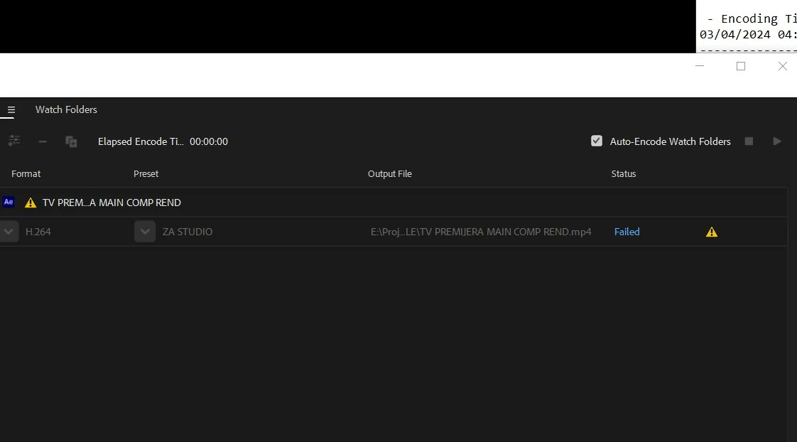

 3 pictures: 1. Media Encoder reports that the video is missing (FREE GUY SA TR TD).
 4 pictures: 1. Don't dump the video (report Fail)
 I also attached the Error log, so there you go.
 Just a note, when I export/export video from Premier Pro via Media Encoder, everything works normally.
In a short way, between After Effects and Media Encoder, something is wrong."

Can you please try the following:
  1. Make sure that versions of all apps match (required for DynamicLinkManager to work correctly). AME and After Effects need to have the same version.
  2. Verify your own AntiVirus / GateKepper setup. If applicable, deactivate temporarily to verify. On Windows, turn off the Windows Firewall.
  3. Quit all Adobe apps.
  4. Use Activity Monitor / Task Manager to kill DynamicLinkManager if it still runs. (On Windows, you need to open the Details tab to see dynamiclingmanager.exe in TaskManager.)
  5. Launch AME first.
  6. Open & export the project again.
You may also check these instructions here: https://helpx.adobe.com/after-effects/kb/after-effects-composition-export-error.html
