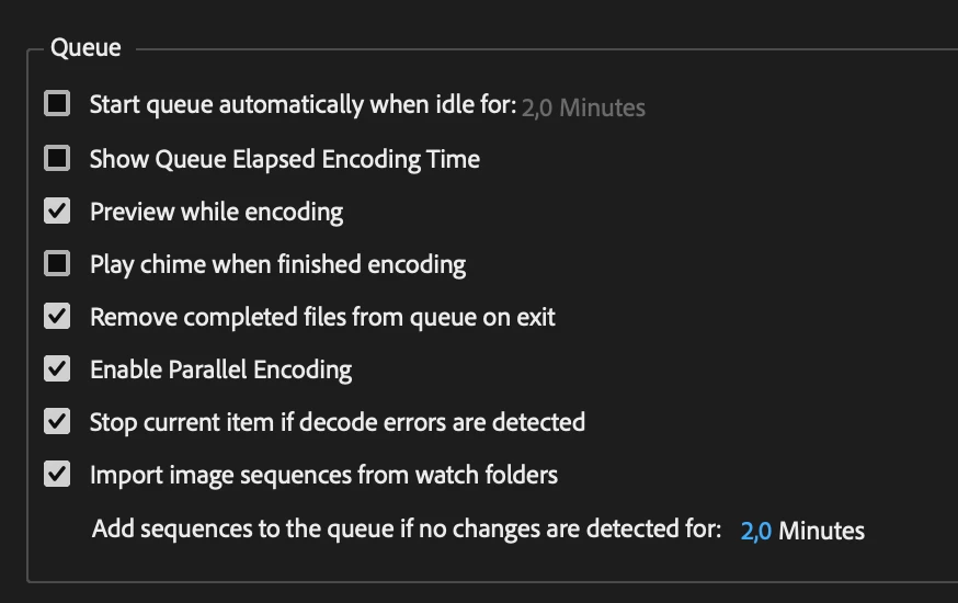

Dec 3, 2024 8:52 AM UTC
So what you could try is, to uncheck the checkbox "Stop current item if errors are detected" in the Preferences under General. Depending on the nature of the corrupt source frames, it could be that we replace them with black frames.
