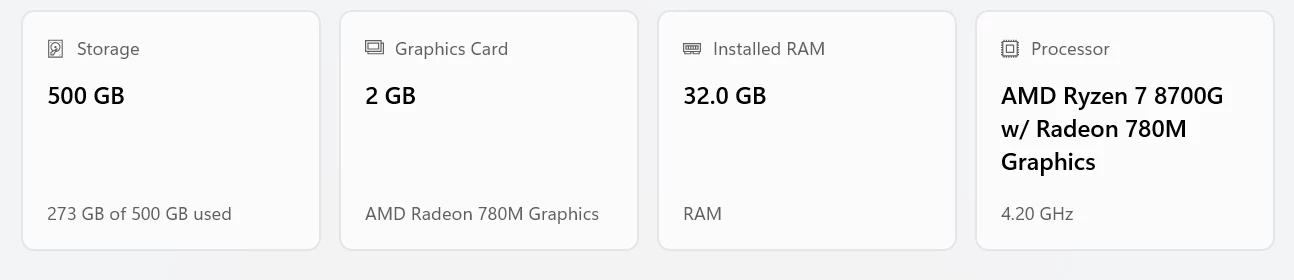

My computer specs

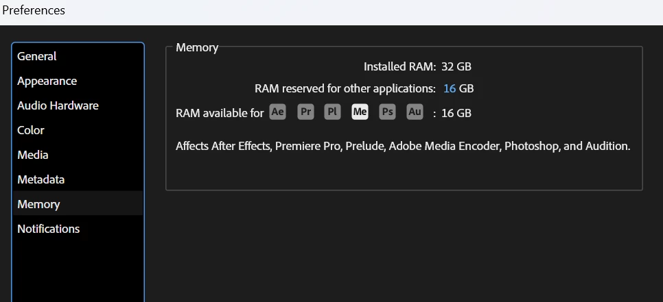

I realized that Media Encoder consumed all memory/RAM and failed although I configed to set the maximum of RAM the Media Encoder app could use
Anyone countered same issue here? Any fix?

3. AME using all RAM: The amount of RAM required depends on frame size (yours seems to be in 4k), complexity of the PPro project, and plug-ins used.
