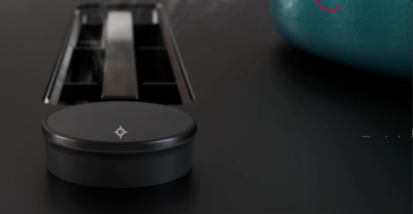

Media Encoder creates different h264 output than After Effects
When rendering a h264 mp4 through media encoder my video looks broken in certain areas as you can see in the screenshot. It just clips some dark colors.
What can I do? This is realy bad as it is really subtle but plain broken.

Try turning off Hardware encoding in the Video tab of the export settings.
