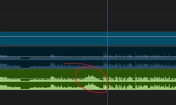

    juin 24, 2026 10:33 AM UTC
    I'm experiencing the same issue. I've already wasted over two hours on that today.
    The blue audio was exported using ME and didn't sound right.
    The green audio is from the video that I exported in Premiere. It sounds the same as it does in the timeline.
    I have no idea why ME changes the audio. It's super frustrating.
    Using the ducking feature in Premiere, seems like ME just began to ignore the amplifying. Deleting cache didn’t help either.

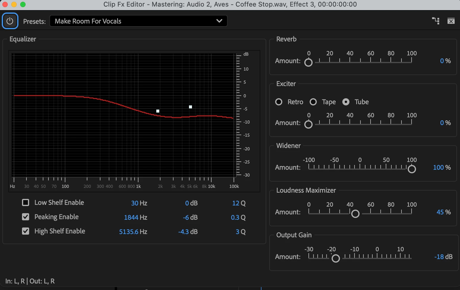

    DigiMakeAuteur
    mars 23, 2026 2:55 PM UTC
    ​@EckiAME & ​@Warren Heaton,
    I think I’ve identified this bug.
    The issue appears to occur when batch exporting sequences that include audio clips with my custom ‘Background Audio’ effect preset applied. This preset is essentially just a mastering effect designed to create space for vocals. I’ve attached an image showing the exact parameter settings.
    My usual workflow is to place the background music on the timeline and apply the preset directly to the clip (rather than the audio track).
    Media Encoder seems to interpret my volume keyframes correctly, but it doesn’t always render the preset mastering effect. This could explain why the music is coming through much louder in the exported files.
    Keen to hear your thoughts? Perhaps this is a note for the developers.
